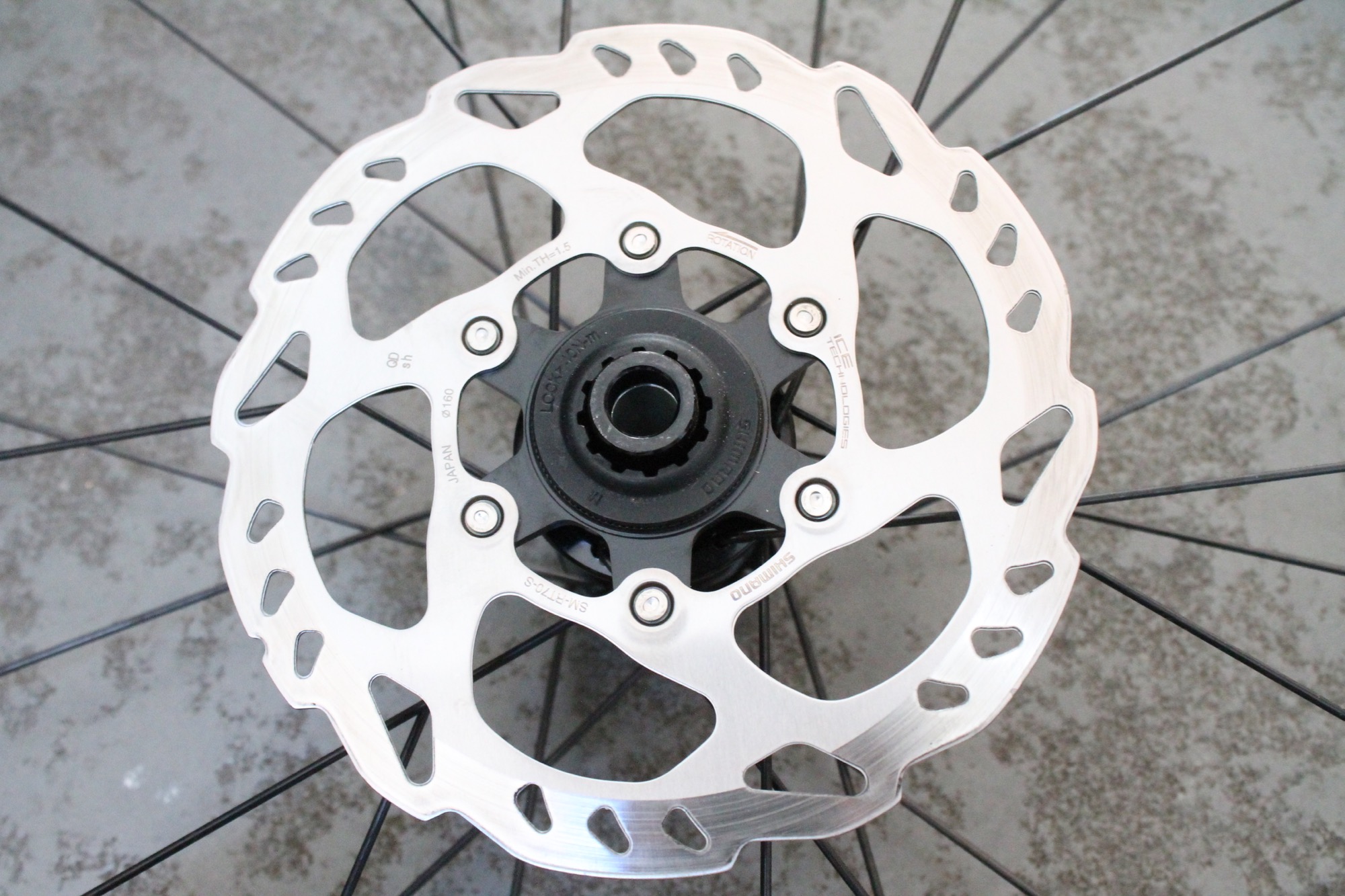

Posts: 17783
I change my rotors pretty regularly.
I've also stopped using Shimano IceTech rotors as this happens to them at a pretty rapid rate if most of your riding is gravity focused.
[url= https://live.staticflickr.com/65535/52292428380_2a6a07a459_c.jp g" target="_blank">https://live.staticflickr.com/65535/52292428380_2a6a07a459_c.jp g"/> [/img][/url][url= https://flic.kr/p/2nEUn7L ]A little worn.😲[/url] by [url= https://www.flickr.com/photos/stu-b/ ]StuartBrettle[/url], on Flickr
https://www.flickr.com/photos/stu-b/52290964357/in/photostream/
In fairness I am averaging around 4000 metres a week and during the summer had some 10000 meter weeks.
Posted : 02/03/2024 10:11 am
