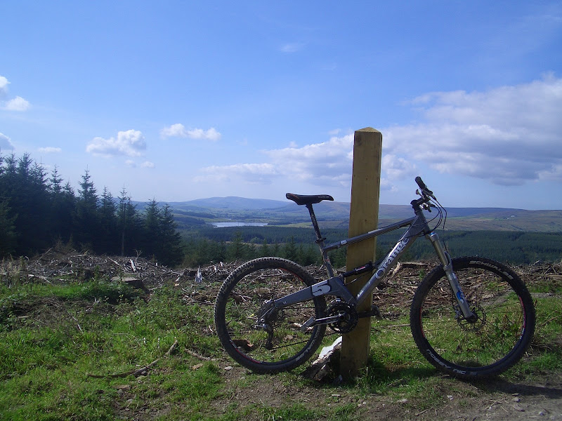

I've got an 06 Orange 5 frame built up with 140mm Floats. I've a set of 640mm low rise bars and a 70mm 6 deg rise stem. There is a 20mm spacer stack under the stem.
When I had a 90mm stem I kept feeling like I was off over the bars. The steering was all over the place when I was climbing too. Putting a 70mm on has cured it to an extent though I now find that the bike doesn't want to turn until the last minute and then it turns sharply.
Should I try a 50mm? Wider bars? Higher rise something? Longer stem, wider, higher rise bars? ...?
What's up?
For reference, here's a pic of the bike setup currently with the 70mm stem.

Re technique, I hear what is being said but I have ridden many many bikes in the UK and the Alps and it's just this particular one (setup) that I can't get used to. As I said above, I've used the bar and stem on my Inbred no prob at all. The upward sweep you see in the pic is a camera angle issue, they are spun back so there's not much upward sweep at the mo.

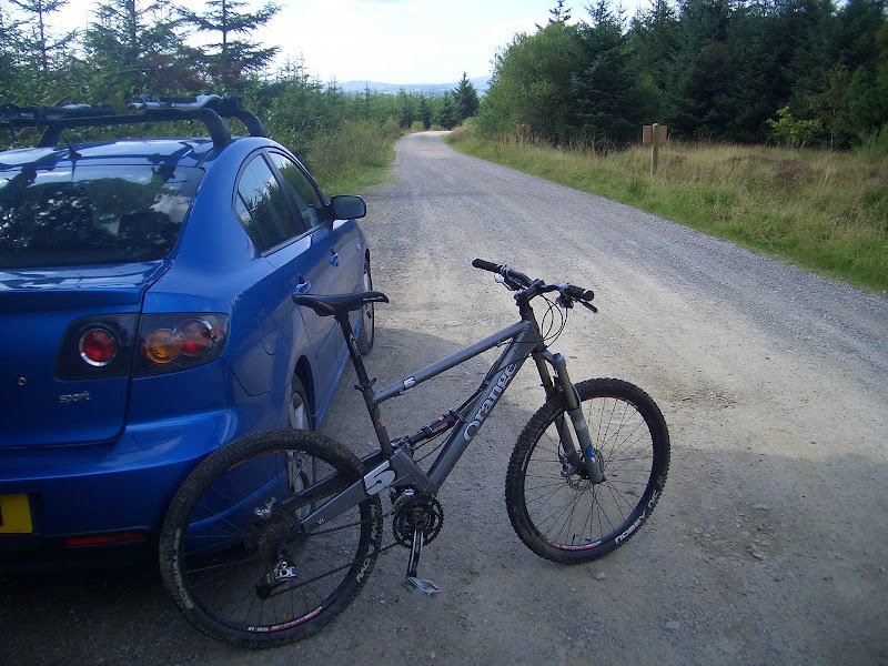

Here's a different angle taken on the same day showing sweep more accurately

did you just want to show off your fancy car ? lol. 8)

Elaine anne - with petrol at 105 a litre now I wish I had a more economical motor!
Yep, suspension setup is definately an issue at the mo, I've been playing with it again today, front and rear. I'm developing a princess and the pea reputaion for suspension setup with my mates 😆
That's Lancashire in the pics sharki but I'm a Yorkshireman.
