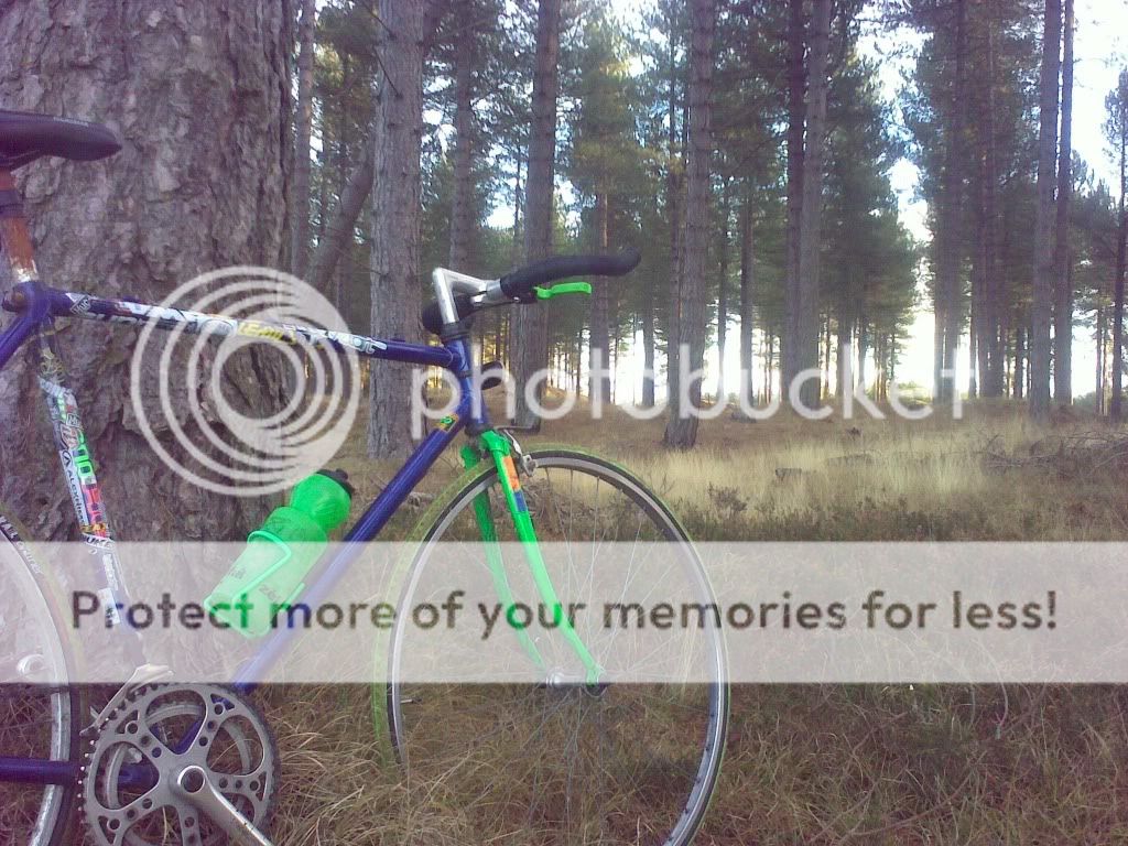

Just been pootling around Tenstmuir forest on my shed of a road bike and got to wondering how my experience would differ if I were on a dedicated cyclocross thing.

Looks nicer today than it did last sunday:
It was the layer of ice under the snow that made it a killer
