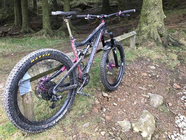

So I've decided for the third time now to not get a new frame, I just cant see an 'upgrade' and why put myself in debt just for something new and shiny! Just had a yearly service 'renew' on the bronson and it felt like a new bike on Saturday and fallen in love all over again.
To keep it fresh and interesting I'm going to upgrade/change some parts and get it painted fresh. So I'm wondering what everybody would upgrade?
Main thing that occurs to me is the forks, there's a worn stanchion and the crown has lost a lot of its black as I was impatient and used the forks before fitting an invisikit. I've never found the pikes particularly small bump compliant either so would like to concentrate on getting that better. Thinking of going 160mm and slackening the head angle a touch as I do ride steep tech when i visit Scotland. At only 60kgs I'm a lightweight rider but not a pansy at the same time. Budget isn't a real issue and the fox 36 are standing out atm.
Can anyone suggest some forks? Or what upgrades would everyone make?

With those massive tyres, can you not fiddle with their pressures to get small bump sensitivity out of them instead of the forks.
Have you actually tired setting the forks up to what you want properly ?
Id try the Fox 34s as your a lightweight (not in a pejorative way).

Just do a proper lowers only service on the Pike, making sure to soak the foam rings in oil. A worn stanchion suggests it might not have been done that frequently?

Yes they're set up properly. They've been serviced properly within the last 6 months, they sustained a stone knock at some point and the stanchion movement has now worn this smooth again and taken with it some of the black coating.
I run 21 psi so fairly low already 😉

As well as changing oil weight, there is quite a variety of aftermarket dampers for the Pike now that aim to get more adjustment.
Or changing fork, Marzocchi 350 has a more accessible feel than the Pike I find.

Pike's don't all that well at 60kg or less IMHO, you can feel a noticeable spike on the damper as you move through the travel.
Get yourself something like a 2 or 2.5wt oil and a charger bleed kit and have at it. If you have some reverb oil knocking about thats probably 2.5wt Torco fluid, which would be fine.

Speaking at a 60kg rider with '16 Fox 36 Factories, I wouldn't go to them if you are after more small bump compliance. They're brilliant forks, but I personally felt the Pikes were a fair chunk better on the tiddly stuff. 36s were better on pretty much everything else IMHO, mind!

Yup, agree with Ben, we're too light for the stock Pike tune. (filling it with bottomless tokens and dropping the pressure may suit you better too)

If you really want a new fork I would be looking at a Lyrik. If you consider keeping the Pike then id fit a vorsprung luftkappe to increase small bump sensitivity and look at redline extra light fluid for the damper. That depends on where you are with settings on the damper though.

Stick with the pike. My wife is really light 45-50kg and fox forks dont work as she is outside of their lower operating weight, It is impossible to get full travel from them. Pikes are fine for her and she can have a reasonable air pressure in them so they work well.

id say stick with the pike. send them to tftuned and get them converted to coil and extended to 160mm. Ive just had mine converted and they feel amazing. the small bump compliance is noticeable better

I've been told the stanchion wear wont effect their performance (by my bike shop and Tftuned over the phone) but will affect the time period between services as they wont have a perfect seal so will let more rubbish past. Tricky to justify spending money on them when I would have to get the crown painted as well as the wear annoying me. I think last time I looked the cost to get new uppers fit to swap out those two issues, it wasn't much more to buy a new fork!
