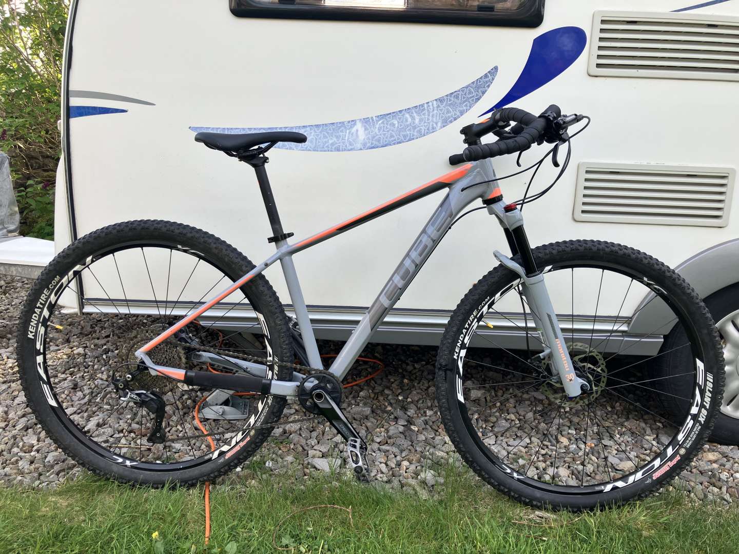

Corner bars would be an easy solutionย
Privateers are generally quite small so sizing up is usually best but probably not an option if you already have it.
I used this 29er for a couple of yearsย

Knock off corner bars for a direct "drop bar MTB" conversion, maybe with a stem swap to dial in position, for easy fitting.ย
Or if it's in bits, maybe pick up some Sensah sti's from Ali express and go full drop bar?ย  Will very likely need a shorter stem for that.ย ย
It all depends what you have rattling around on your spares box, and what time and resources you want to commit.ย
