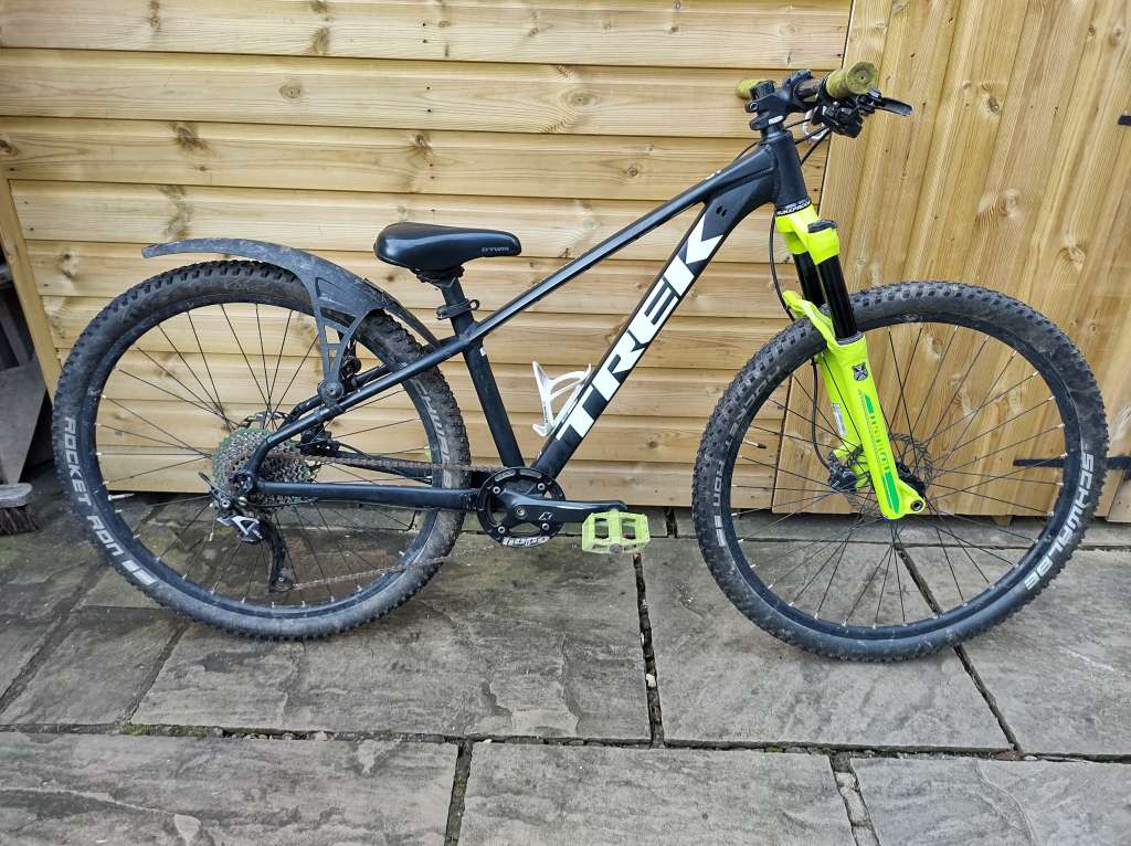

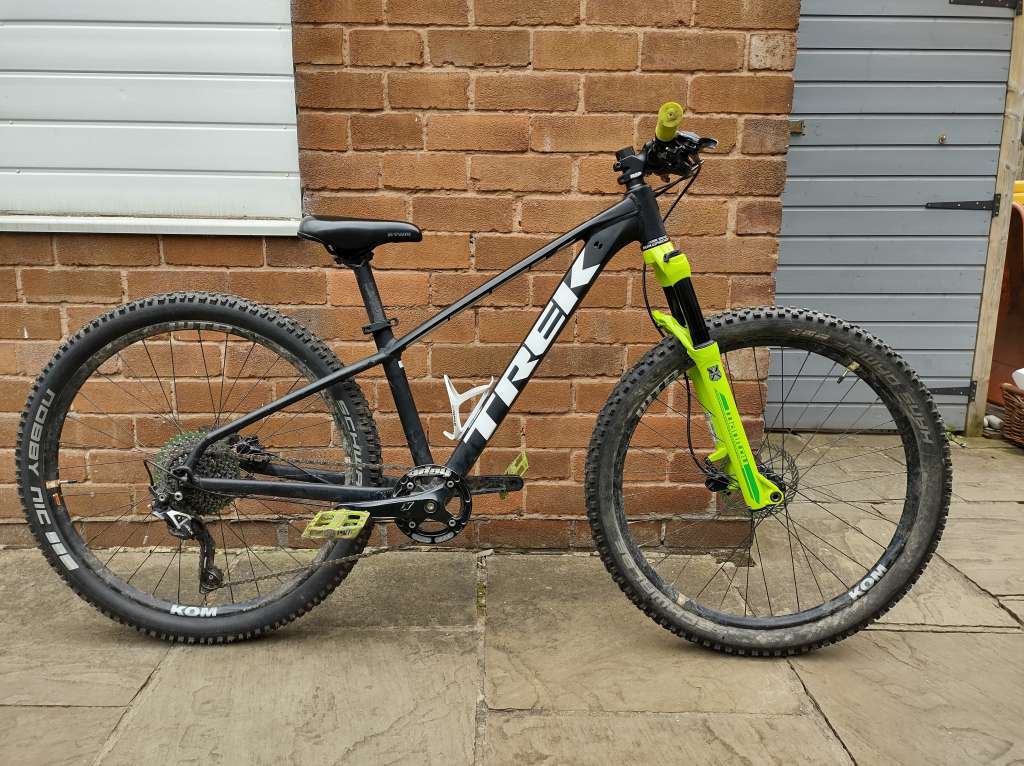

I had a 26" wheeled Giant Trance for my lad, I think the more recent liv models come in really small sizes as well. Also had a Trek Marlin 27.5 which has a 13.5" frame, started daughter off with 26" wheels then stuck some 27.5" wheels as she got a bit bigger. Shes just moved up to a bigger bike which will last her years now.
I keep meaning to put it up for sale actually. Was going to keep the fork and build a DJ/pump track bike but think I'll just sell the lot.
27.5" wheels
IMG_20240217_123427875_HDR
26" wheels
IMG_20211014_104948806_HDR (2)
