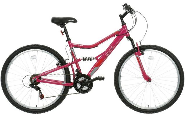

This?
[img] http://i1.adis.ws/i/washford/190730?w=637&h=403 [/img]
I'm kinda serious BTW.
