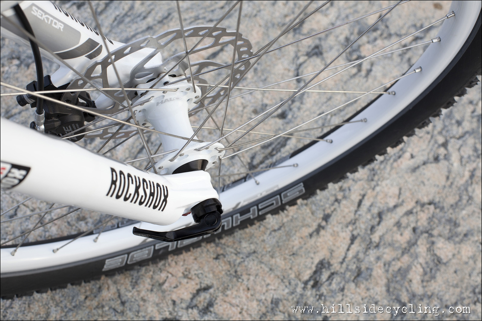

The RS Sektor TK Solo Air I got on my [url= http://www.vitalmtb.com/community/Hillside-Cycling,26127/setup,24730 ]Cotic Soul[/url] is 130 mm from stock, with a 15 mm Maxle lite. Light and stiff:
[img] ?1391629602[/img]
/Leo
