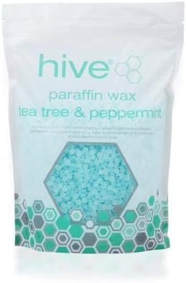

Posts: 41786
Tempted to give this a go, £8 and definitely won't smell of sulphur!
