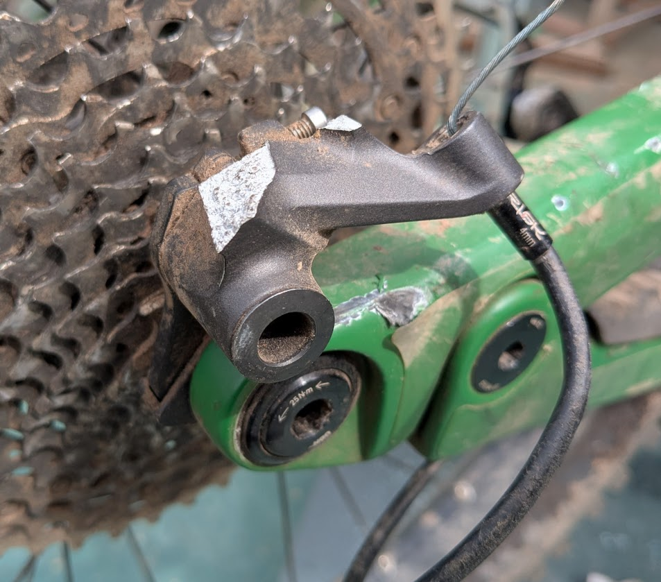

UDH. Sucks? Or does...
UDH. Sucks? Or does it?
Posts: 1291
Just riding along:
Complete rotation and into the frame:
Not a pretty site, but the frame survived:

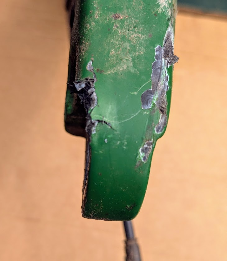

I've sanded the paint off and a bit of epoxy will tidy the damage up.

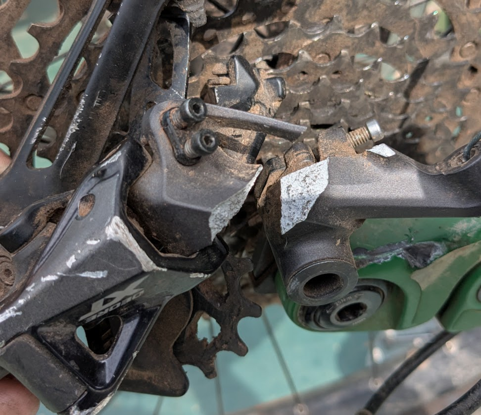

I guess the question is would another style of hanger have just snapped? I can see the advantages to the UDH, but this is the second time I've seen the UDH hanger rotate and cause a mess. (not my bike BTW)

"Just riding along" - Photos suggest the derailleur snapped in two after a bad crash and that smacked into the frame rather than the hanger?

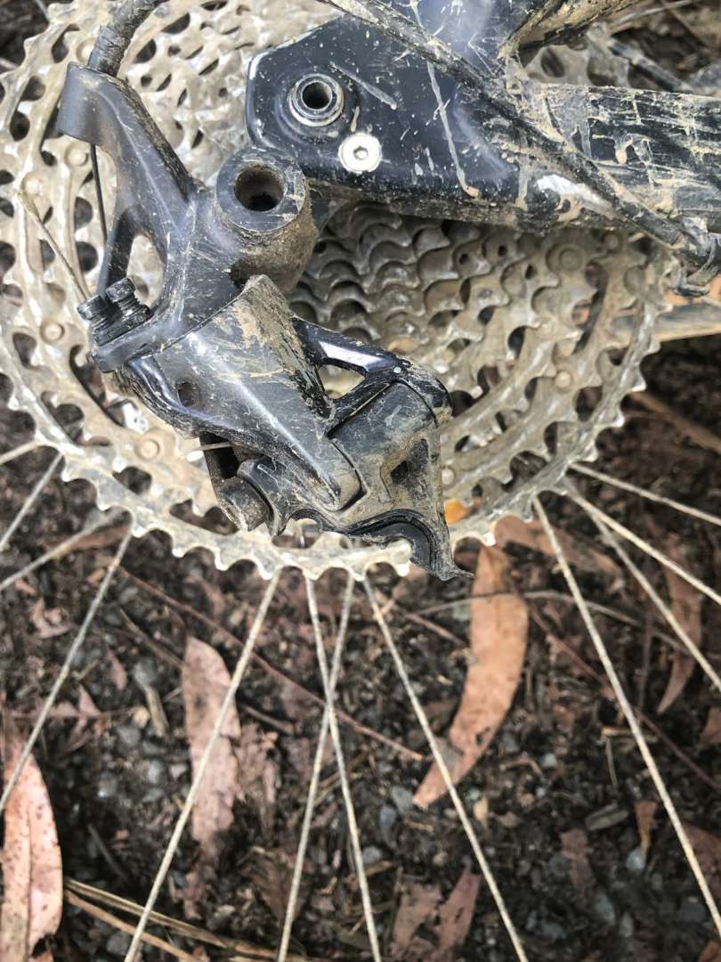

This has been my experience as well.  I can't find my post right now but I did two mechs in two days on a Basque MTB trip the other year. The first I know I put it through a narrow gap between two rocks, the second I was being super careful and it did feel like JRA.  Both times the mech was destroyed and into the spokes, the hanger rotated, and chunks taken out of the seat stay.
The first one was a place I'd bashed mechs on previous bikes - scraped/bent mech but a much less extreme failure mode.
I'm really not a fan.  the rotation just seems like a bad idea - I thought it was supposed to allow the mech to move backwards without being damaged but it seems to do nothing of the sort.
 the hanger needs to be put on with a reverse thread, to a high torque (which meant buying a new torque wrench).
I can't help feeling this is an absolute master stroke by SRAM.  They've sold the industry into a new standard that is great for SRAM T type mechs but a much worse solution than manufacturers previous hanger designs for anyones else's mechs (I've wrecked a load of mechs and hangers over the years, but UDH is the only one thats' damaged the frame at at the same time)

Bike is a Canyon SpectralON. Running the original hanger which is metal with a plastic shroud. The plastic section (I assume) stops the rotation. I'll have a closer look later today.
I was in front when happened, so I didn't see the incident. Not a high speed crash though, most likely clipped a rock. I'm thinking of weakening the replacement hanger somehow? Some small holes in a line above the mech mount perhaps? Suggestions welcome.
I might also think about a strip of aluminium bonded to the top of the swinging arm to spread the load if it happens again? Sods law says if I do this it will never be needed.

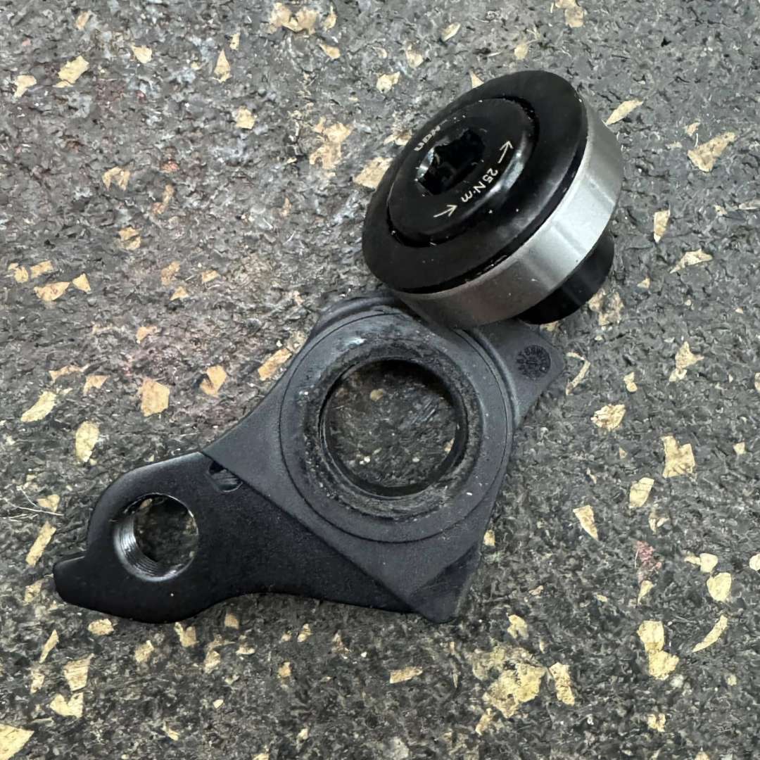

Happened to me last week, but I think i hit a rock. The shimano axle failed rather than the udh hanger. The UDH hanger rotated and was undamaged. Had similar damage the the chainstay/dropout as well.

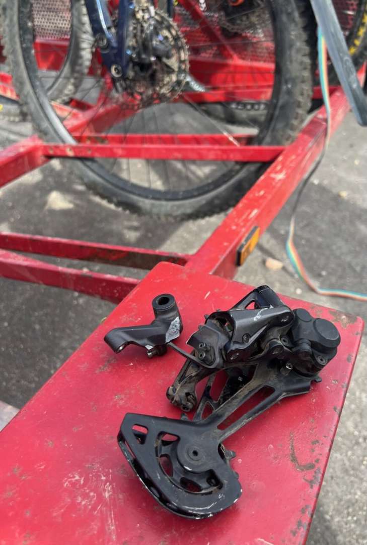

I've had a UDH IMG_8070.jpegIMG_8071.jpeg rotate and bend.
Son had an XT derrailleur snap recently but not with a UDH.
His coach was riding behind at the time and said he didn't hit anything.

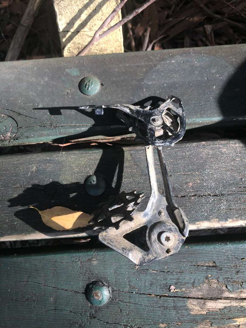

I don't seem to have a picture of the first I broke, this was the second one.  There is a minor scrape on the mech but really not much for it to have completely self destructed.
the day before the main link snapped, both plates bent, both jockey wheels snapped.
the other pic is the result of over tightening. 466038275_10160242808941723_9285329537614752_n.jpg

Erm anyone with one of those broken hanger, wanna send me the bolt? (happy to pay costs)
I somehow stripped the axle thread, and have stolen my spare's bolt to fix it.. got a unbroken hanger with no bolt (& a new one on it's way, but hey ho).

I take it you mean the LH thread bolt? Happy to send you the one of the above bike. Message me.

Managed to break one while assembling a bike that had arrived disassembled in the post, on the plus side it was easy to get a spare.
My Gen 2 Levo still has the Spesh proprietary hanger and the mech rotated and snapped while the hanger remained in one piece much like the ones above so I take it as a "shit happens" kinda thing.
