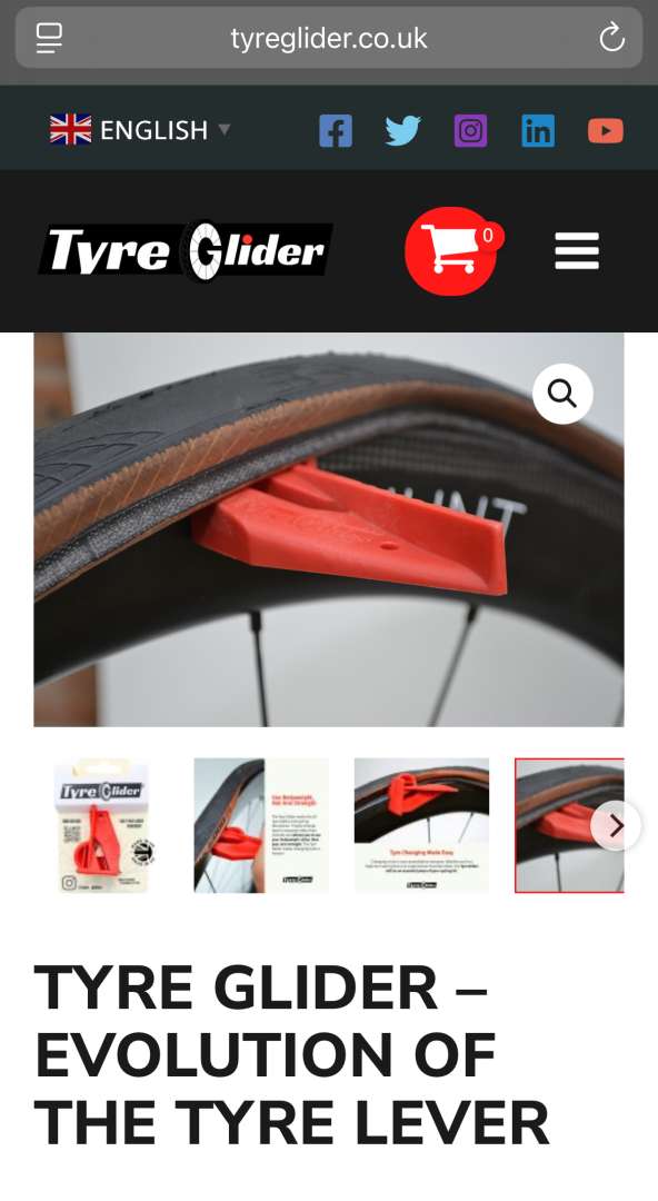

Posts: 487
What you need is a Tyre Glider!
bought one after a recommendation on this here forum. Brilliant tool 👍
Can’t seem to post a link, but have a photo instead..

That tyre slider thingy wouldn't touch them.
