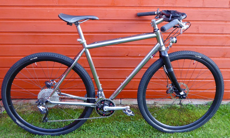

 I dunno, I think it looks pretty good with an alt bar set up.
Re: 1x conversion - a GRX chainset will fit fine. you'll need a decent size cassette at the back which means you'll probably need a new derailleur too, unless you've already got a GRX one that can handle a wider range.

Hey Slackboy,
Stange question I know, but how do those bars feel compared to straight bars? If that's possible to explain 🤣
I've never ridden such bars so I'm entrigued.
Also, is that a MK1 ATR? what size tires do you have there? I'm thinking of beefing mine up a bit. Do the job, but wouldn't mind something a bit more plump!
Regarding new gear....I think I replaced stuff 5-6 years ago and everything is getting a bit tired (I've had the frame/forks) for 10 years, so a complete strip down and re-build is about right.
For me, two...actually no 3 points of moving to different bars.
I never ever ever use the drops and in fact don't feel too safe with my hands on the hoods when it gets proper bumpy.
I hurt my elbow and notice when I ride my ATR for 40+ KM's and more my elbow starts to ache. But yet I ride 40+Kms every day with my e-bike and flat bars and no issues after a weeks riding.
Lastly, if I go bike packing, it's a bit of a squeeze to get the the roll pack inbetween the the brakes.

I was only joking about the flat bars. Jeez some people are so serious! I think the pic slackboy posted was actually somafunk's bike.
