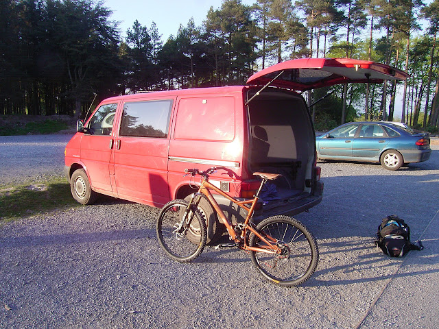

Mines running Marzocchi XC700s 90-130 on the 06 model. Usually set at about halfway. 130 downhill is fine. Hope internal headset works well.
[url=
for picture[/url]

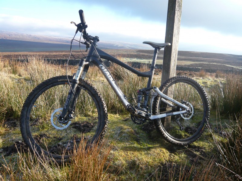

Posted : 20/03/2009 12:05 pm
Here's a snap of mine shortly after I got it, taken up on the Dales. Brilliant ride!
