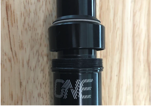

Hi,
On my 210mm on-up dropper the collar kept unthreading itself over a ride, so I put a little too much blue loctite on it to stop it doing so.
Worked beautifully! now I need to service the post, feeling a little rough, and I cannot get that collar to undo. I've tried a straprench but it ain't budging - there is not a lot to get purchase on either.
How can I loosen the hold that the blue loctite has to allow me to remove the collar?
Note - I have also chalked this up on the long list of 'things what I have learned by doing it wrong'. also, this image is not the V2 post which has a smaller collar.
thanks!

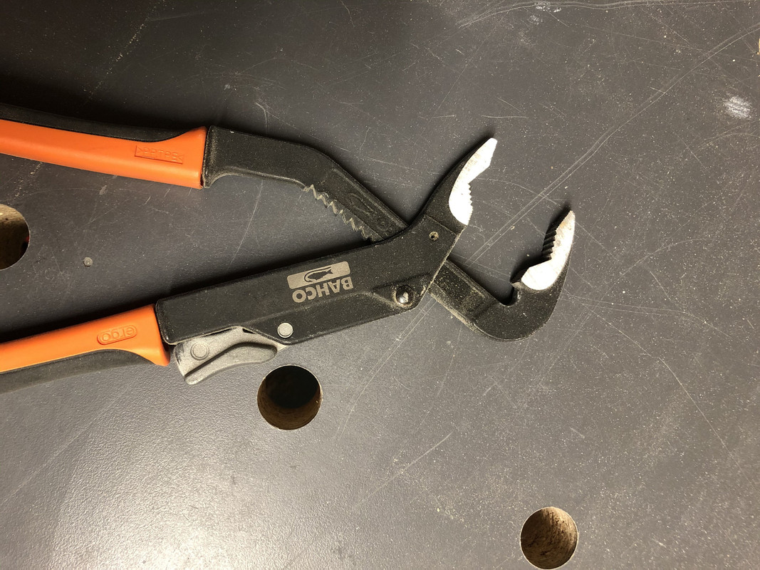

@big_scott_nanny you anywhere near east lothian? I'll loan you mine if that would help. Search for Bahco strap wrench.
Posted : 16/12/2020 8:30 pm
Posts: 3334
@Davesport - quite close, Stirling, but I got it fiexed.
To let interested folks know - hot water worked, plus taping up the collar and using a pair of these borrowed from the neighbour. Job jobbed, got a lovely slidey pole again ๐Ÿ™‚
