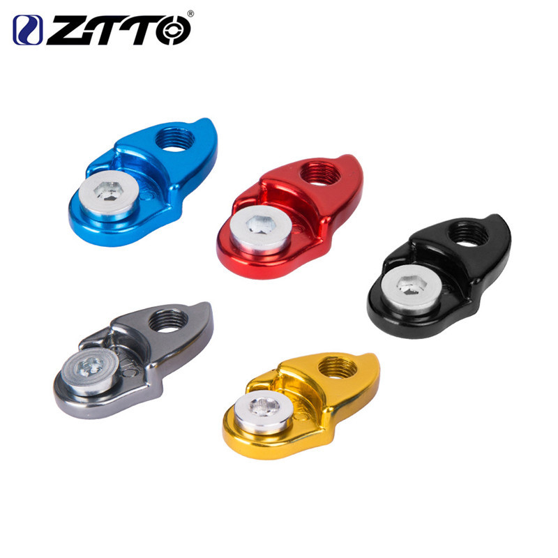

What do I need for this mech and a 46 t?
Posted : 30/09/2019 12:40 pm
What's the largest sprocket on that cassette and what's the mech? How much adjustment is left on the b-screw?
Posted : 30/09/2019 12:56 pm
Posts: 17191
46 tooth with a long b screw.
In one gear it just slightly tings under power. Thought I'd remedy that.
Posted : 30/09/2019 1:14 pm
By "one gear" do you mean first/lowest gear or a random "one" in the middle of the cassette?
tings? As in Uptown Top Rankin'?
Posted : 30/09/2019 1:17 pm
Posts: 17191
It's either 3rd from the wheel or 3rd from the drop out that tings like a wonky disc.

Try one of these before you throw any more money at it

Joemmo , I did!
The bolt that comes with that is a weird size that fits absolutely nothing on the planet. So thought I'd get the proper thing.

That one just bolts onto the hanger and then you attach the mech to it, it doesn't replace the upper link - just in case that's what you tried
No Really?
I got one and couldnt work out where it went. so got the Goatlink, which works very badly

I tried it again, it wont work. Its this one
Theres a tab on the back
to engage with the mech hanger. But it gets in the way on my bike so wont bolt down. Im going to file the tab off and try again

I had to mod mine with a dremel to fit too

I fitted one thus:hanger
it's running with a 11-40 but with hardly any b-screw applied so there is a lot of adjustment still available

Tried mine again,which nw fits, sticking out the back, but very little contact between my mech hanger and this jobbie, so probabl something will get damaged.
Now my gear cable is too short to refit the mech to it.
It looks like the mech will be too far back to engage much of the chain on the cogs

Goat link fitted and my gears shift like a dream with no ting.
