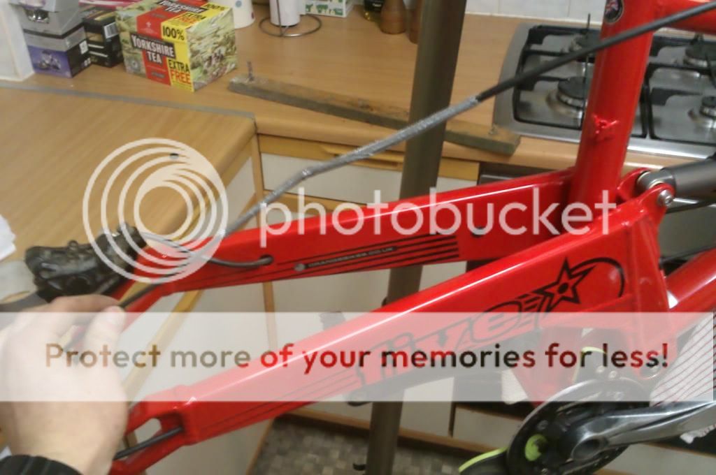

Straightend out wire coat hanger worked for threading the gear cable through the swing arm on mine. shove it through back to front and stick the cable outer on the end then carefully pull it back.
I'll do the brake hose when i need to bleed them.

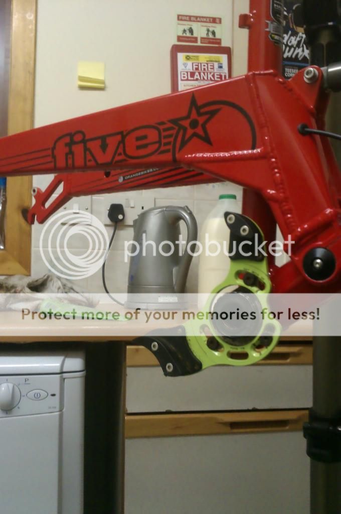

Took a LOT of filing, but ISCG solution now working. Does anyone have any top tips on how a Silentguide should be orientated on a suspension bike? I only ask 'cos I've seen loads of slightly odd looking setups around and about.
Will try the coathanger trick on the hoses...

RE threading the cable - put a small kink in the end of a gear gear. Thread it down towards the rear. Spin it using your thumb and finger. It should - with some luck - catch in the hole.
Then just thread your outer over it.
Posted : 12/11/2012 6:09 pm

To thread it - get some cotton and a hoover. Hold the the hoover to the rear hole, making a seal with your hand, and switch the hoover on so it draws air through the entrance hole. Push the cotton in through the hole until it gets picked up by the hoover and pulled out of the exit hole. Tape the cotton to the cable inner, then pull it through and thread the cable outer over the inner.
(I want pictorial evidence of you trying this)
Posted : 12/11/2012 6:30 pm

Hoses threaded. Good GRIEF that was an arduous task. Coathanger trick worked for the gear cable, then my housemate had the genius idea of taping the brake hose to a gear housing. Worked a treat.

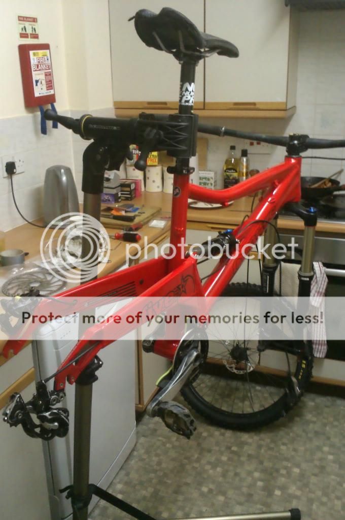

I'm still here. Break for tea, followed by a very long time trying to get the rubber grommets between the frame and hoses back in. I gave up in the end. Just getting the brakes bled now. What a farce...

I got distracted again, and then it all escalated quickly.
Nearly there...
Posted : 12/11/2012 9:29 pm
+1 point for leaving the wok on the cooker whilst leaving the bike in the kitchen.
Appeased the G/F, then leave her to sleep it off and stick some wheels on it.
The fish BTW was inspired.
Posted : 12/11/2012 9:38 pm

Ok, I'm calling that finished. Took flipping long enough eh?
Still a few bits of tinkering to be done, but if nothing else I think it looks the business. Fettling tomorrow, then Innerleithen Wednesday for a full shakedown...
Posted : 12/11/2012 11:18 pm
