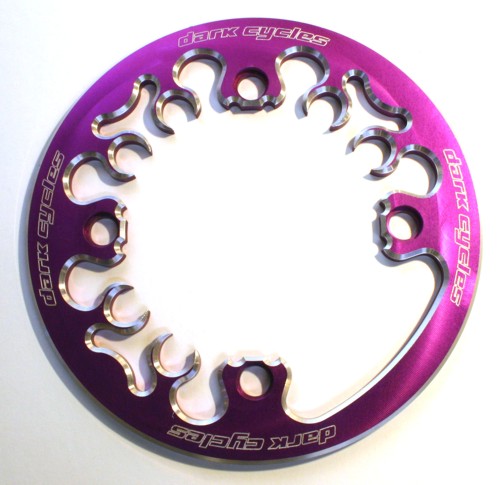

just ride faster & get one of these 😀
Top gear with no fear..
