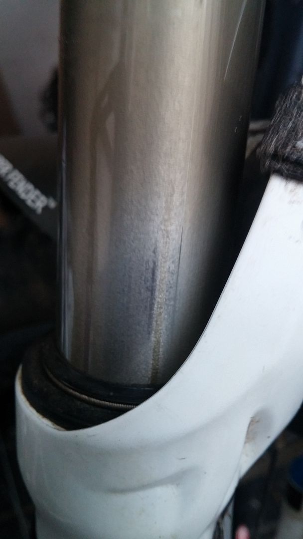

Posts: 1012
I service yearly normally. Last year I had new uppers fitted. These are my uppers today
Posted : 07/04/2016 8:55 pm
Posts: 4847
Fox ?
No Eyed Deer my thoughts with rear shock ( til now )
Posted : 07/04/2016 9:00 pm
Posts: 1012
Yep, Fox F29
Posted : 07/04/2016 9:02 pm
Posts: 4847
I rest my case , I got new uppers then I flogged my 36s , nothing seems to have changed . I remember seeing a leaflet from Fox in my LBS ( Pre Kashima ) recommending a strip down every 25 hours !!!!
