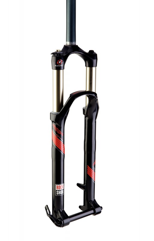

'09 Reba?
http://www.merlincycles.co.uk/?fn=product&productId=1500&categoryId=18
About as close as you're going to get, save for 20mm of adjustment and 5mm thicker axle.

I think the '09 Reba is as close as you're going to get (120mm travel, Maxl light, assorted bells and whistles, about 3.6lb), but you don't get the travel adjust.
Must admit to wanting one for my Soda, but I'd rather have 130mm travel...
