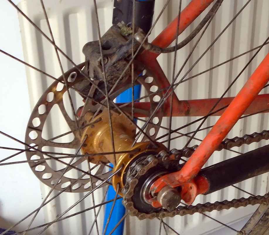

I'm with you on a somewhat irrational avoidance of the chain tensioner. Tensioners can work absolutely fine, as can stinger type chain guides and some other solutions. My just retired 26 singlespeed had/has an eccentric hub, which i liked but I wouldn't favour over various other options and I don't think exists in today's axle standards anyway. However I do like sliding/swinging dropouts and personally if I'm buying a frame for the purpose I'll narrow it down to those with tensioning options built into the frame.

Trackends are athletically the nices imo but you need a chain tug on drivers side to give a constant reference for minimum fuss replacing rear wheels.

tried tugs didn't like 'em and as for the cheesy nature of hope allen bolts I went for "proper" bolt up rear end :D.
No slippage in 7 years.

tried tugs didn’t like ’em and as for the cheesy nature of hope allen bolts I went for “proper” bolt up rear end :D.
The tug for me is not to stop slippage but to give a reference point to make taking the rear wheel in and out easier, if you need to that is.
