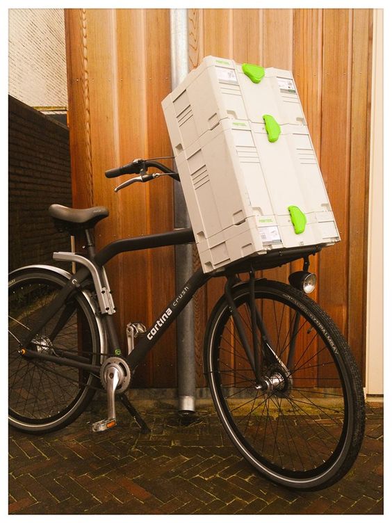

Posts: 8396
That's Systainer size footprint.
It's an interlocking box system sold by Systainer but also used by Makita, Festool, Panasonic and other power tool makers. You should be able to get a selection of empty boxes, drawers and organiser inserts to suit your needs, there's always a ton on ebay. Not cheap, but super robust. You'll also be able to get clips to put into the base of your rack so the whole thing just clicks in and out as needed. Like this:
