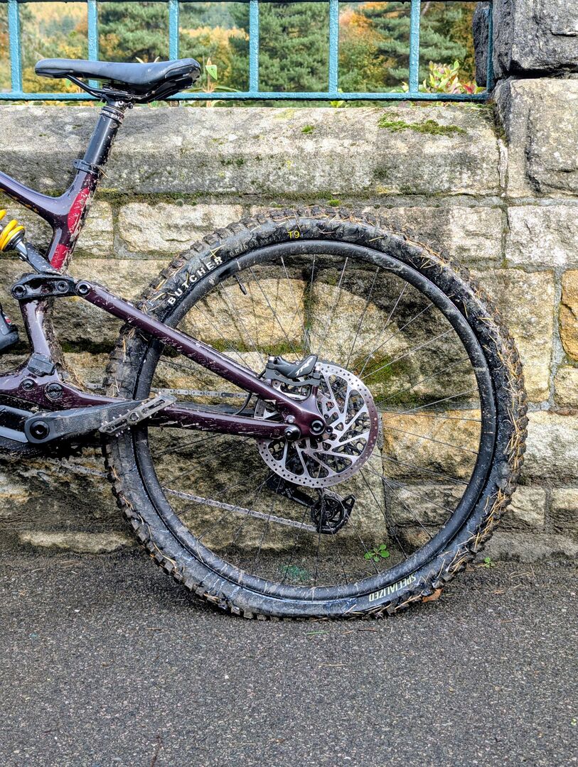

I had to quit Specialized tyres again. Yes, they are a huge improvement over the old models but they're still not as good as the competition.
When I bought the Levo SL in September last year I was pleasantly surprised by them on dry, dusty trails. The new Butcher's are admittedly miles better than the old ones.
Then I got used to the bike and started winching and plummeting on manmade trails with jumps and berms and was disappointed, especially when it got cold and wet. They feel skatey and plasticy on cold, greasy trails.
Even with nearly 30psi and Rimpact inserts I had 3 complete dismounts of the rear tyre.
I swapped them for enduro casing Kryptotal's which are better in every single way. Absolutely no issues now with grip or burping.
If I wanted to just pedal around on easy trails they'd be fine but I don't so they're not. I'll put them back on when the wife wants to start riding again.
Photo from a very short trip to Wharny.
