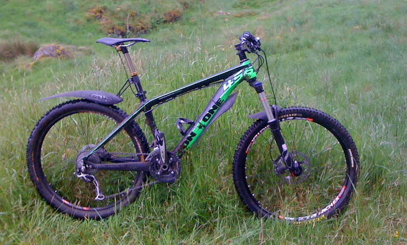

Posts: 8859
As Nortwind says, whatever you do, DO NOT buy an on one smoothie headset. Even at it's reduced price (£29?) it's wasted money. I ride my bike maybe once a week and the smoothie HS lasted 6 months. I've just changed it for an One One/Works Components Slackset. I've been really happy with 140mm travel forks on it. not sure how the new slacker set up will feel tho.
As others say Deore/SLX, there should be lots of bargains about now it's coming to the end of summer.

Posts: 8859
In my pic above, everything except the saddle, brakes(Rosebike), chain/cassette and headset were off STW classifieds, ebay or slight 2nds from friends/family. fag packet calculation is approx £1000 and I managed Fox 32 140mm forks, Superstar Superleggera Ti hub/Stans Alpine rims, Shimano 2012 XT brakes, bel air Ti saddle, SLX cranks, Enve/Edge handle bars, all mostly 2nd hand of course, but nothing has been a bad purchase (except the headset).
