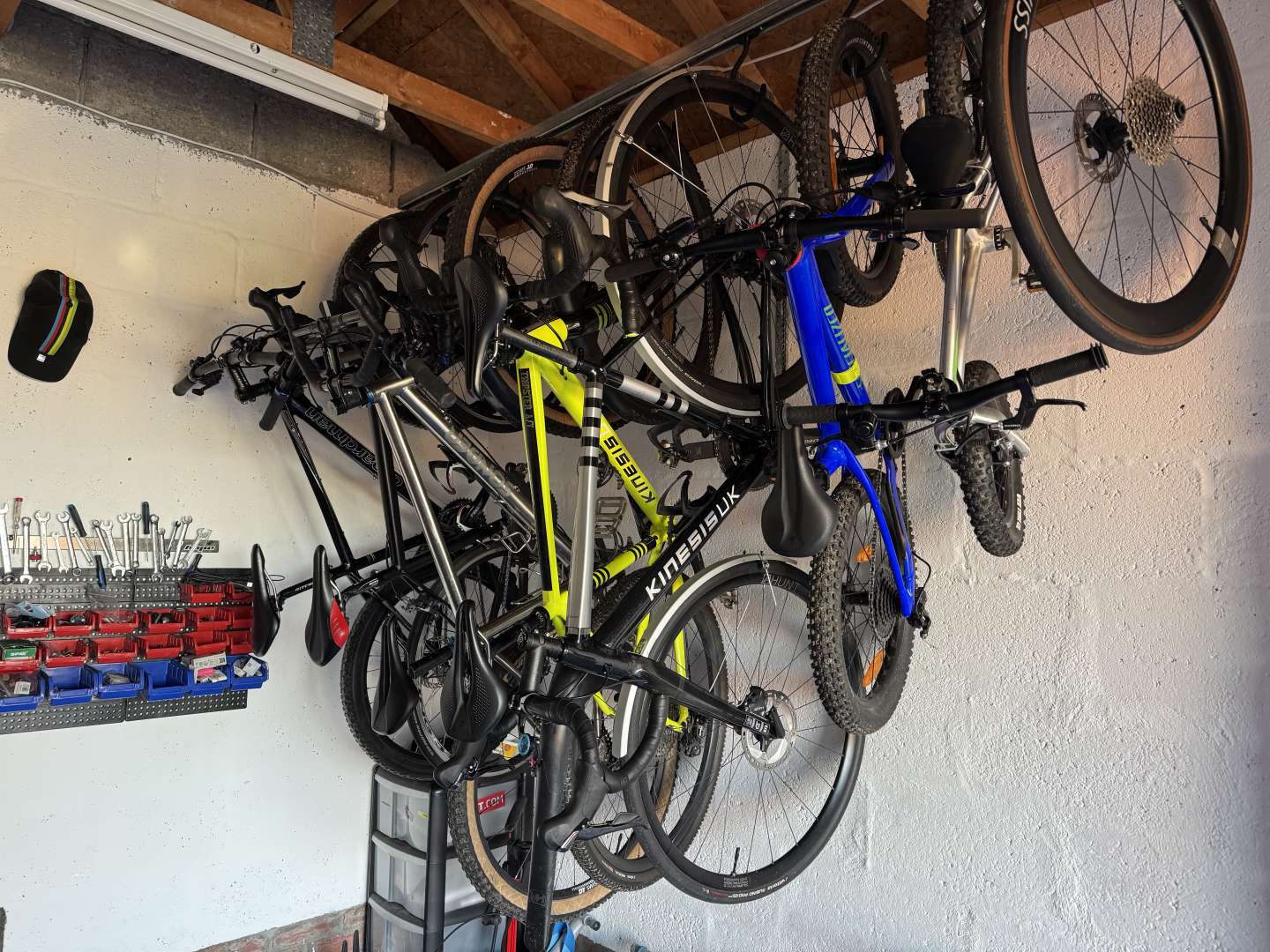

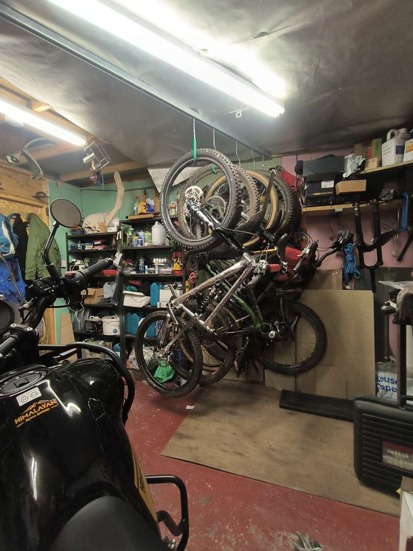

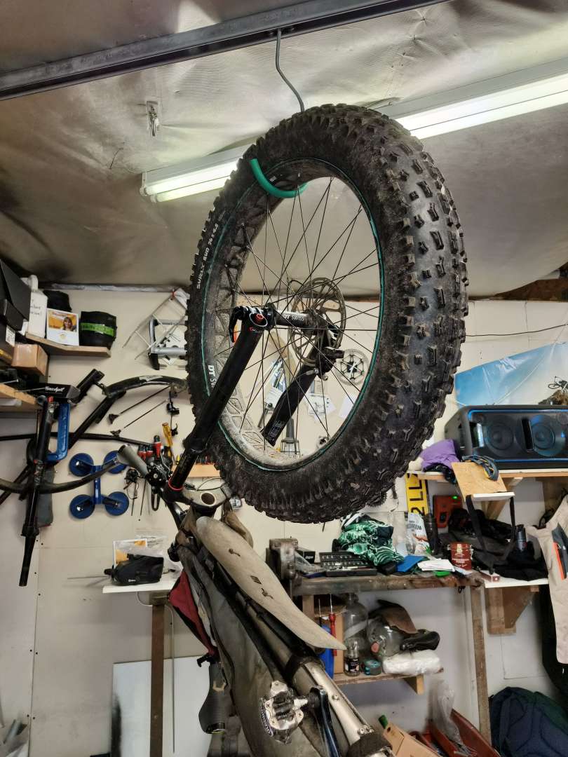

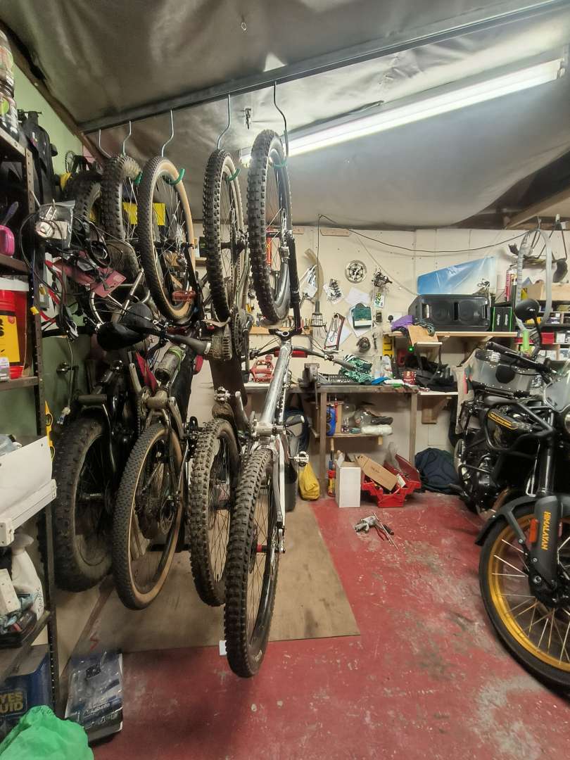

So I bought the Decathlon one and then regretted it! Its actually a really good, very simple to fit set up, but I just don;t really have enough height in my garage and I'd have been better off with the rak.bike system off ebay. Its totally my fault as I rushed it and didn't think how much space between the rail and ceiling I would need for the rollers, and I then forgot about the roof timber as well.... Obvs with the unistrut system it doesn't need any space above. Saying all that, I'd have had to fit it to brackets as I don't have a solid ceiling and not sure if the rail would be strong enough between brackets...
Any way, couple of photos of my set up now. I have my road bike at the end hung off the rear wheel, then my hardtail hung off the front wheel, this is where the height is an issue as it literaly only just fits with the rear wheel on the ground. Then I have 2 enduro mtbs that are hung from the rear wheels because I neve put the front wheels on when at home, as they go in the van on fork mounts attached to a peice of wood. This means I can rotate the bars to give easier clearance for my daughters bike between them and means she can get it out.
I then have 2 other bikes hung from S hooks on a scaffold pole at the other end of the garage. I used to have a few bukes hung from saddles on the scaffold pole and other under them in a floor bike rack thing, but that just meant I couldn't get to anything....

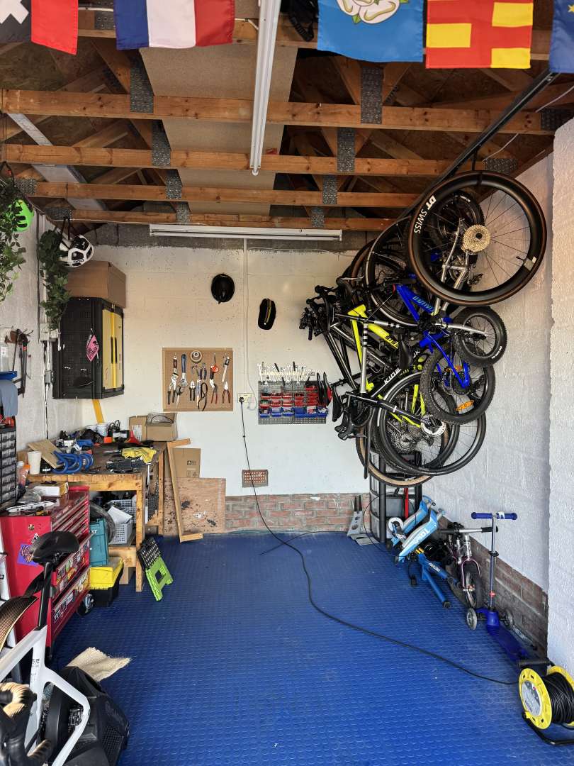

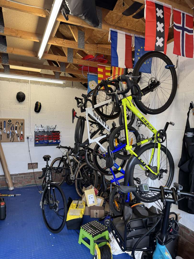

Posted by: dmorts
How far from the wall have people installed the rail, both at the side and end? I'm thinking about installing a Unistrut based system, utilising the full 3m length. It would have to go onto the ceiling soon after delivery as I don't have space to keep 3m of something lying around. Hence doing some forward planning
Mine more or less butts up the wall at one end, there's a slight gap where I can get a roller in and out but in practice that doesn;t happen.
It's fitted 41cm out from the wall - I didn;t measure it, just guessed. I started a LOT further out (like 60cm+) along the joist, but that was too far, so fitted battens between joists and used that. I could go closer in but then you start to get issues of the wheel hitting the wall while you get it into the hook. This way the bikes rotate and the back wheels end up on the wall - makes it a little easier to slide bikes along too, I suppose.
Posted by: BearBack
are you seeing issues with bikes swinging together (two teenage boys) when moving bikes aside to get the current flavor down?
I've worked out a sequence which gives me pretty good clearance on the various handlebars, though I'll need to revisit that at some point - 2 MTBS at the far end have the bars rotated at 90 degrees, but then again one of those is being sold. Might be selling a drop bar bike too which will free up a little more space still. It means there's plenty of space to move bikes along and clear (a little) space to get something out, but I still take care when I'm moving bikes to avoid crashing them into each other
Posted : 11/04/2025 12:21 pm

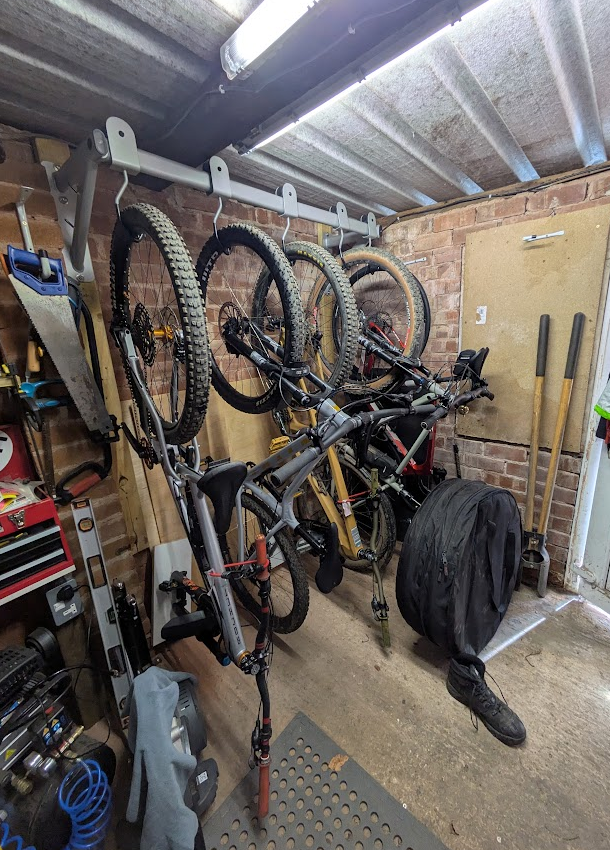

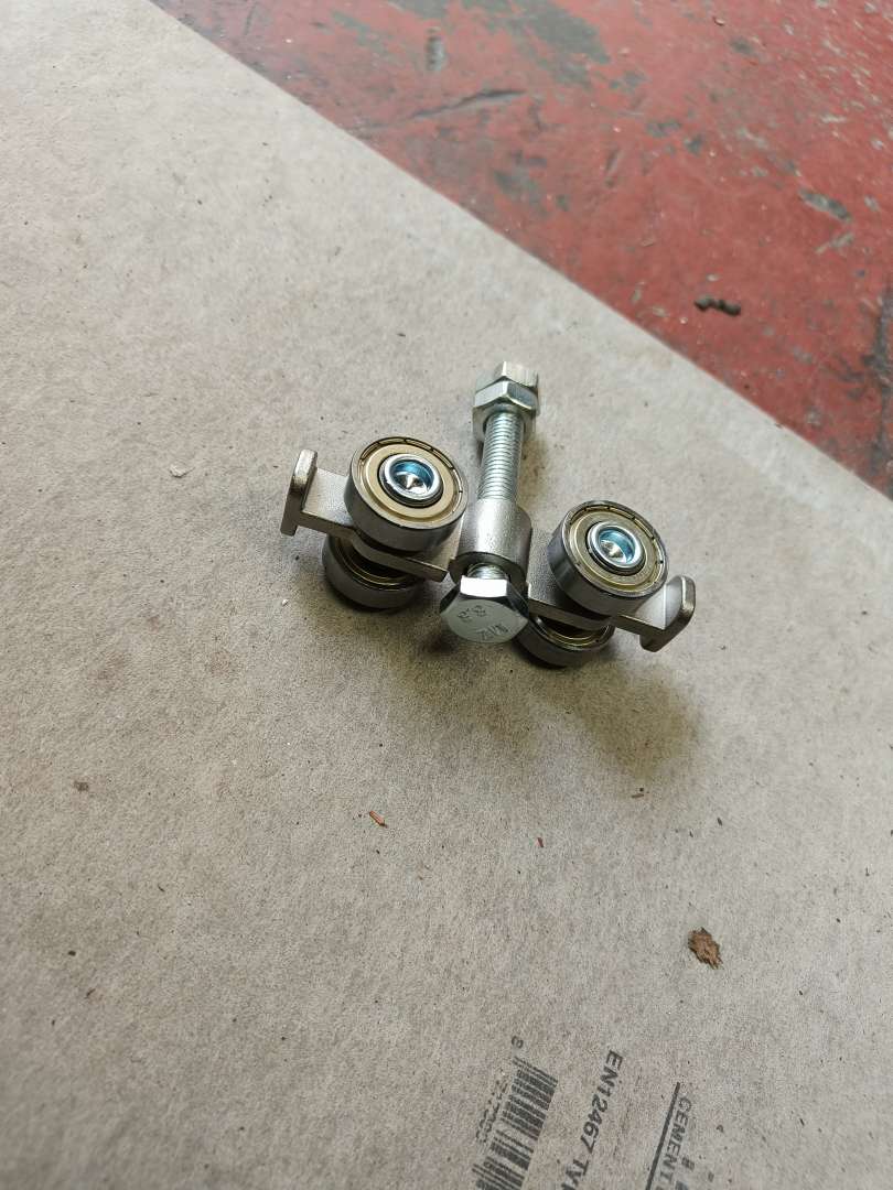

Posts: 3057
I didn't spot this thread until last week, after I'd been inspired by a recent post on Peter Verdones blog.
I wish I had this setup years ago, it's so handy for shifting bikes around for access.

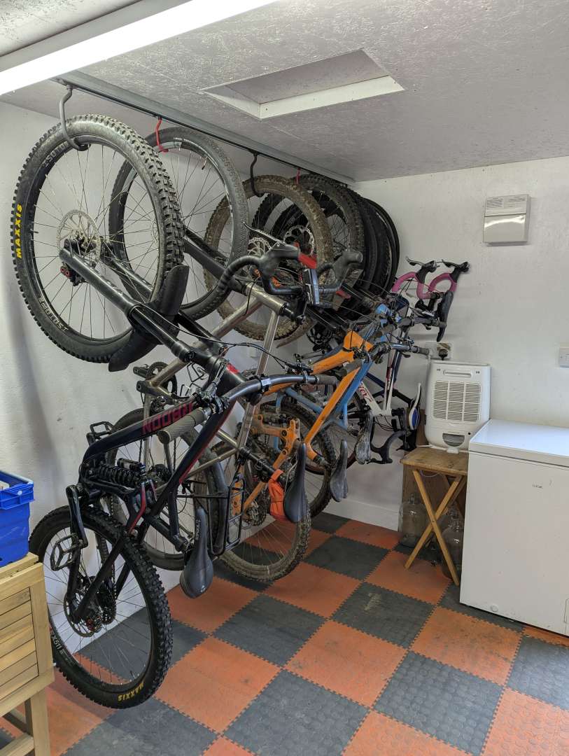

All five bikes, and the motorbike, can be shifted in and out with ease, as well as moving them to access the workbench and vice.
£20 for a 3M unistrut, £40 for five bearing trolleys off Temu, £4 for 3M of M8 threaded rod to bend into hooks.  Offcuts of garden hose to cover the hook.
Posted : 12/04/2025 9:53 pm

Posts: 941
@nbt that's an interesting picture above as
1) you've hung an Orbit tandem and they take up a lot of space. How easy do you find it to remove/hook up the tandem with hooks that don't turn?
2) have you noticed any flex in the garage ceiling as it looks like 4-5 bikes and the tandem hanging off the joists. I did note you have put battens across two joists which is what I'll probably do to spread the weight.
Nic
Posted : 13/04/2025 8:15 am

Posts: 12469
Tandems are probably the easiest bikes to hang: put the parking brake on, back up till it’s standing on the rear wheel then walk it into position. Only a minor lift then required to get out on the hook
 I’ve not noticed any movement in the ceiling at all - but now you have me worried 😳😜

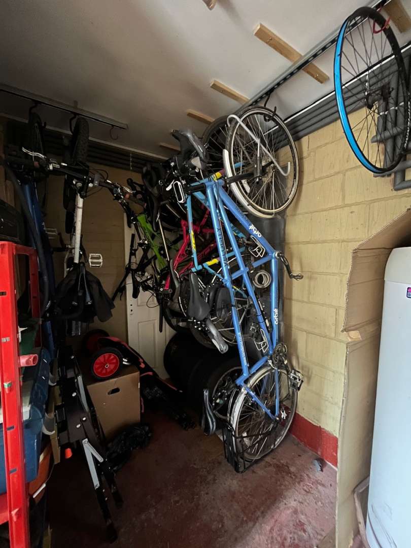

Posts: 4376
Just a note to say thanks to the folk on this thread I'm almost there putting up a rack very much like the OP. THe only sticking point is the local courier* hanging onto my bit of unistrut for 2 weeks now, but once that arrives I should be good to go.
* I even chose the same unistrut supplier as @namastebuzz as it seemed to work getting a long thing delivered to Northern Scotland. it turns out I'm in the wrong bit of Northern Scotland to expect anything silly like the delivery of good I've paid for (including an enormous surcharge for the shipping).

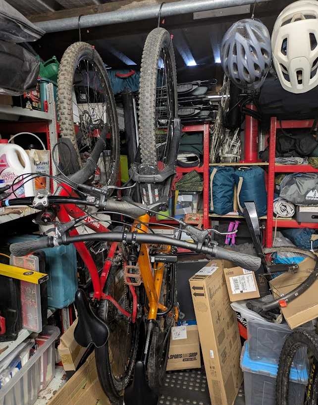

Unistrut arrived yesterday, bike monorail installed in less than an hour today.
Here's before:
And after:
