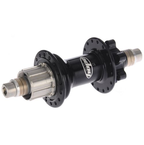

i use the singlespeed specific hope offering
[img] http://media.chainreactioncycles.com/is/image/ChainReactionCycles/prod113664_Black_NE_01?wid=500&hei=505 [/img]
though mine is gold bling has stainless steel freehub thingy and more pickups on the ratchet. I think that just means it sounds like an angrier wasp than usual ๐Ÿ˜‰
