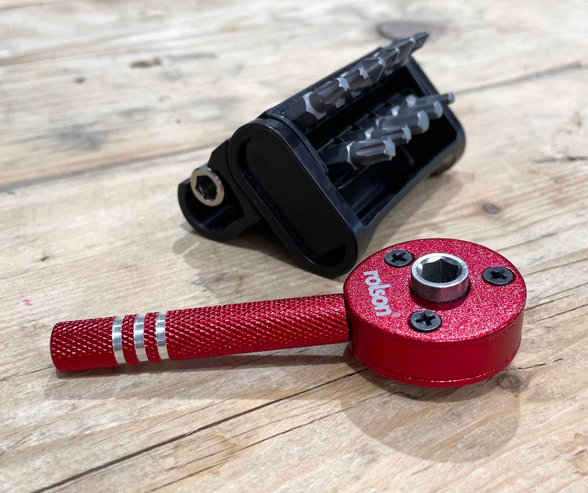

Posts: 31281
Little Alu bit ratchet... £2.99 from TragoMills.
