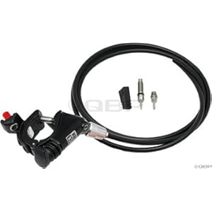

Firstly, my reverb came with a load of stuff I'm not sure what it's for!
What's the silver collar for? Oh well....
When mounting the MMX remove [b]without[/b] the MMX brake etc, am I supposed to put the black 'blanking piece' in the space on the remote clamp? Or is it Ok to mount the remote clamp without that piece?
You see on this image, where there's a big 'gap' in the clamp....

I just removed the mmx bit and mounted the lever. The silver collar is to limit the drop I think.
Recommend you use fibre paste on the seatube and only do up the seat collar as tight as needed. If you over tighten it won't work as smoothly and will knacker it quite quickly.

The silver collar on the lever? That regulates the return speed... it's got a little + and - on it.
As for the blanking piece.... Does it perform any structural function? you're not talking about the little black thing in the photo are you? Thats the "dust" cover for where the hose meets the post.

Rubbish how there's loads of bits included and no reference to them whatsoever in the manual or online!
Silver collar is the 'enduro collar', designed to limit drop so you can set it to just have a small drop if you want.
I did not use the black blanking piece. No problems so far.
