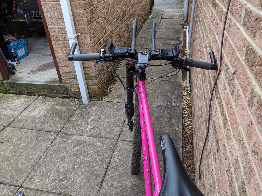

For my rigid mtb that does long distance, i have two additions to the carbon bars
i) some cane creek rubber type bar ends that extend forward and slightly behind the bar. This allows a really comfortable geip where the end of the handlebar is in the palm of my hand. Really really comfortable.
ii) i add a pr of aerobars with forearm rests. The ones shown above dont allow you to rest your weight, and you are always tensed to stop yourself slumping forwards. The aerobars with rests prevent this. Thay can also be angled so you can choose a variety of positions from 'flat' to 'praying mantis'.
In option ii) i would recommend aerobars that are adjustable. So the reach is adjustable, but so is the placement of forearm pad. A set of Profil t2 are what i use and are about £25 used on ebay
Ian

OK, £6 brand-x bar ski-bend bar ends ordered, I'll probably try them on my On-one Fleegle bars first similar to Whitestone's arrangement above, but I do like the idea of some slightly swept back carbon bars, am not sure I get on with excessively swept bars.
I'm intrigued by the aero bar idea but I think this flatters my 'long distance' aspirations too much, and I'll only be using this bike when the going is likely to be too rough for my drop bar gravel bike (i.e. when I want suspension forks!) so I think it's unlikely I'd be able to rest in the arm-rests very much, I just want the hand position of a set of hoods.
Also just found some Kenda Small Block 8's in a 50m width (well, 1.95") which should be the perfect complement to the setup, happy days!
