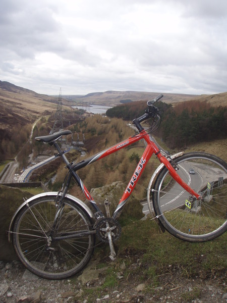

Not on a commute btw. Just part of the trans pennine trail as part of a ride
Bought a trek 4100 rigid from a local freeads paper as I wanted an MTB to take the knocks of dodgy kerb mounting and the odd few stairs and not kill the wheels. A short commute meant the weight shouldn't be a real issue and at the time thought it may be usable as a spare MTB if really needed
I've had it offroad a few times and its behaved well enough. I put a 2.5" High Roller up front when I took it round the peaks. Made it quite fun once you'd your head round the arm pain
I realise its a bit shiny, so not really a hack, but the guards and 26" slicks on a 21.5" frame don't really do it any favours in the looks department
