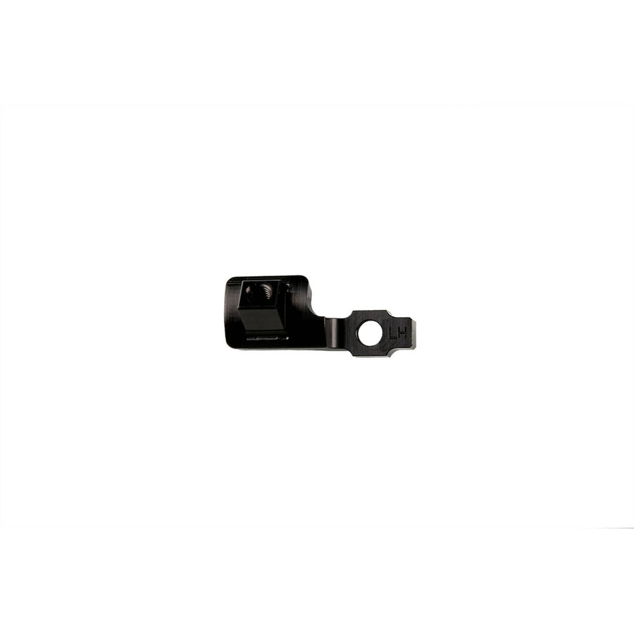

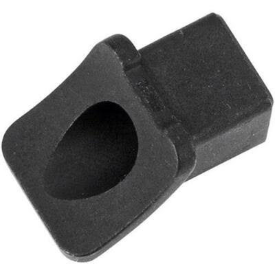

This for your shifter:
This for your dropper:
Posted : 30/01/2026 1:52 pm
Posts: 14698
Thanks - but the 2nd one says tech 4 to EV - suggesting it's for Hope brakes??

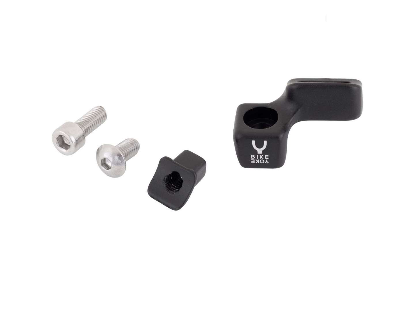

Apologies.having a look at the dropper, it looks like something like the OneUp Shimano adaptor would work.ย
Posted : 30/01/2026 2:39 pm
Posts: 3542
Also this one from Bike Yoke. Chap mentioned it on a review of the dropper in the Bike Tart website.ย
https://slam69.co.uk/products/bikeyoke-triggy-i-spec-ev-adapter-remote-lever-clamp
