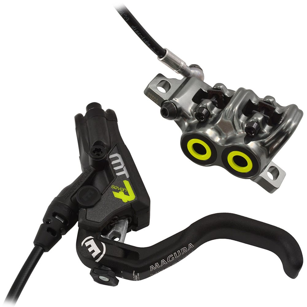

@julians the only MT7 model we can get here is this one:
There are enough riders here having bought ridiculously expensive imporyed brakes (Hope is another point in case) who turn their noses up at "normal" brakes. But there's no sign of riders with Galfer or SRAM high end rotors. They balk at the cost of relax and ng them!
/blockquote>
Yeah,that's the same as I bought for £120 each end, £240 in total.
