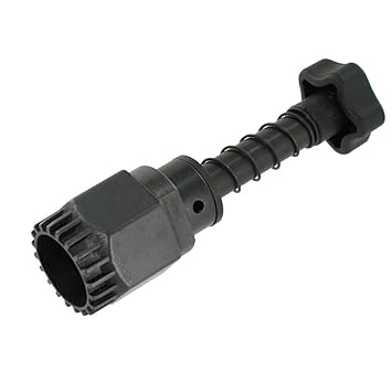

Part of the problem is trying to get the tool to stay in place when I turn it.
Is it square taper? If so I may be able to assist: I have a VAR tool like this, and the spring holds the tool in place:
If it's Octalink or ISIS, I think the [url= https://www.bikeinn.com/bike/var-bottom-bracket-tool-for-shimano-octalin/136086940/p ]latest version[/url] will fit:

Bolting the tool to the bottom bracket - much like shown above - as recommended by Paul Davies kept it in place well enough for me to clamp it and use the frame for leverage.
I now have a new smooth BB in place.
