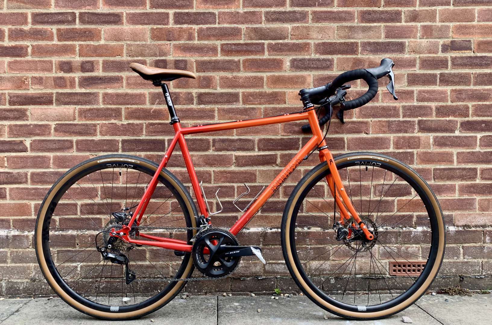

Over the last five or so years I’ve ridden less and less off road defaulting to gravel or the road.
For the road I have a fixed Genesis Day One which is ace, but has its limitations.
I also have this. Frame and forks from here, 105 11 speed group set from CRC ages ago and a splattering of nice, if not bank breaking parts.
I guess you’d call it road plus?
It’s a nice ride, that until someone else tells me otherwise, fits me well.
It’s a bit of a lump though. That said so am I.
I’d like to lighten it up a bit but with the sliding dropouts and straight steerer I guess any upgrade would be relatively minimal weight savings wise.
Possibly wheels?
Tyres? Currently running 40’s 🫣
As soon as I start looking at upgrades I’m drawn to starting over with a new build or buying off the peg.
But … I’m somewhat of a steel Luddite so I don’t know how I would get on with a sub 20lb build - I appreciate you can get a steel frame comfortably under that weight.
Given I’m only racing myself do I just keep as is?

Do you tend to climb a lot of hills and do you like attacking them?
My '16 carbon Cube Attain GTC Pro Disc arrived weighing 9Kg, with Shimano 2x11 105 5800 groupset plus br505 brifters. I've switched out the alloy seatpost and bars for carbon, plus switched out the alloy Fulcrum Racing Sport 77 wheels (that came with 25mm Conti Grand Race Sport and butyl tubes) for carbon VEL 50RL wheels (with latex tubes and 25/30mm premiumish tyres). A fraction under 8.5Kg iirc.
Aero will usually start to trump weight savings if you can typically climb faster than 12mph, moreso the faster you can manage.
These days, you would probably have to spend £1500+ in a sale on a good day, to get a carbon framed hydraulic brake road bike with wheels weighing close to 2Kg.

Are those Gravelkings?  I'd have thought some nice speedy road tyres for the summer would make a considerable difference to the feel albeit not much to the actual weight, perhaps with lightweight TPU tubes.  Something like Vittoria Corsa -I use the Corsa Control variation which has good puncture protection for the odd (dry) gravel linkup between quiet roads though a few watts penalty over the standard or speed variations.

Did you take the pic with a wide angle lense ? The seat looks like it’s point down, the bars pointing up and the frame big, but top tube length short !
Nothing wrong with 105 though, I wouldn’t pay more money to upgrade it. Maybe when things wear out upgrade but each time I think about doing that with my 105 , you cat beat the value, and the weight saving by item is minimal
IMO road bikes, if you like the look of it , then it will be fast and you will ride it. If it doesn’t look good you won’t ride it and you will blame it for making g you slow
Agree with above, tyres will help. Not sure what those rims are, but decent aero rims can transform how a road bike rides
Posted : 04/06/2025 6:50 pm

@FunkyDunc … I think the image distortion is down to my rather lacking photo skills than the bike set up!
Saddle is level as are the tops of the bars (transition into the brifters).
I’ll definitely look into tyres.
Wheels are off the peg hope 20five wheels with RS4(?) hubs.

If that saddle is level then the bricks behind it are well out.
Posted : 05/06/2025 9:56 am
Posted : 05/06/2025 4:37 pm
Posts: 4910
Oh you lot leave my bricks alone … 😂 I won’t be bullied into trying to take a better picture (showing the perfectly level saddle) 😂
