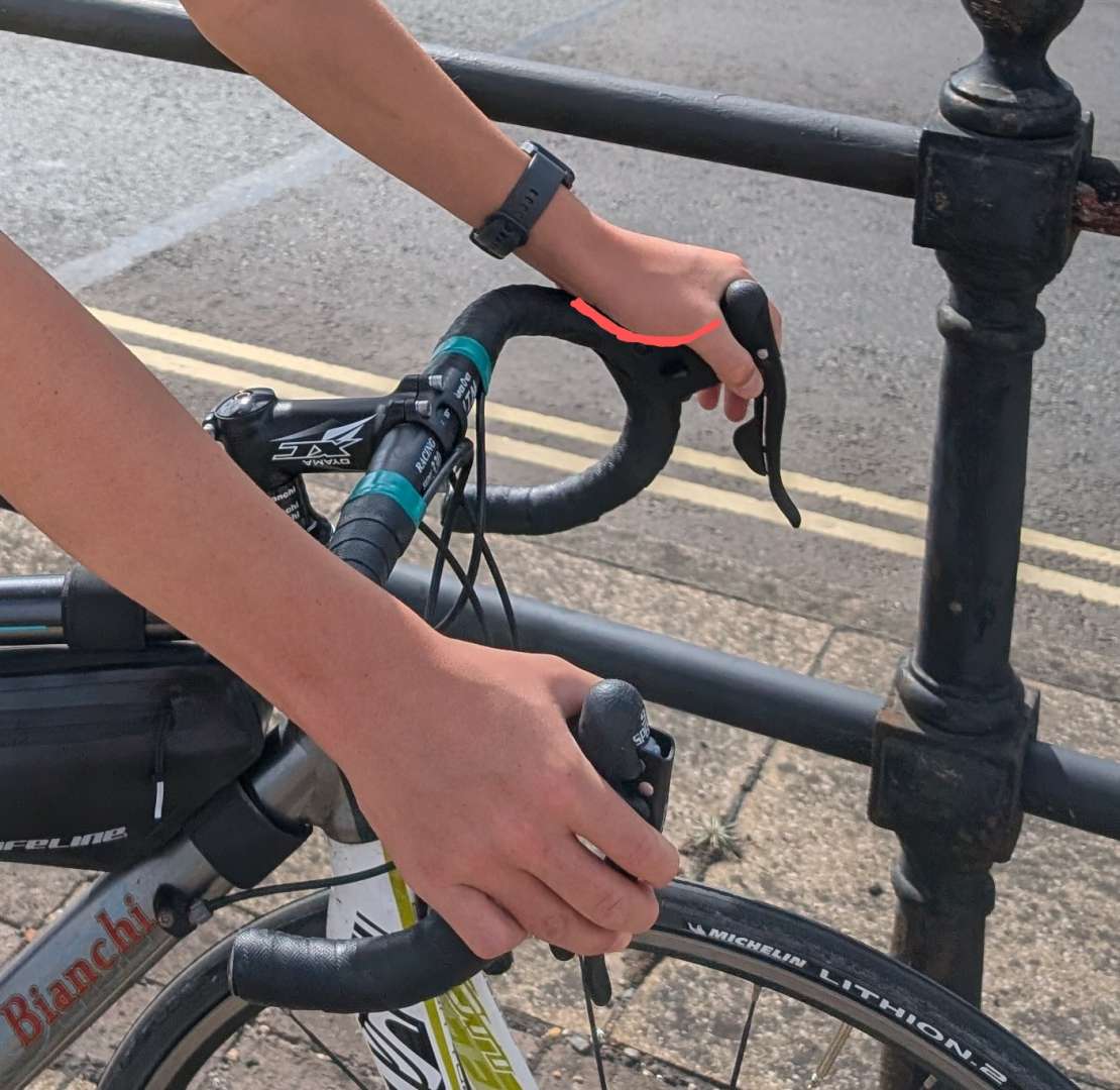

I pulled out a couple of pictures of our bikes (my bike fitted one and my two sons' bikes that we've had much more luck with setting up at home as I can watch them ride) and then looked at yours again.
This is just roughly based on that and the fact you have some fit issues that sound similar to some of mine and from what I remember from my fit and some common symptoms I had with yours.
Saddle
Looks to be pan flat.  Since my bike fit all of ours are nose down (just a little).  What I was told is it causes your hips to rotate into the right position for pedalling efficiency but it also helps your upper body lean into the correct reach as reaching forward doesn't strain the hip joints.
I'd say the amount of nose down is about one "notch" on one of those old school toothed seatposts.  In your picture my saddle nose would be overlapping that next metal railing in the gate.
I was dubious (for about 3 minutes) but again the natural action of your legs holds you in place not your arms.
Saddle might need to come up a bit to compensate.
Bars
One other thing I am looking at is your bars.  The bottoms look like they are pointing down (at the back).  But also the section from the tops to the hoods slopes away towards the hoods before the main curve and your levers are pulled up really high and so tilted back, which I guess is to bring them closer.
That shape will give you a little V at the base of the brifters and an awkward kink at the wrist. That might be contributing to you favouring gripping at the base of the brifters as it doesn't aggravate the wrists.
I had a set of bars with similar geometry on my old Bianchi.  It created an awkward wrist angle in behind the levers.  They went in the bin very recently as my son (who has acquired it from me) immediately hated them/spotted the issue.  See pic.
The new bar is essentially flat from the corner of the tops until the main drop curve when the bottoms are also flat.  The brake levers are then up near the top of the curve.

Looking again I think I did your bars a disservice as it's hard to see on the phone screen

Posts: 17321
Langster has a higher bottom bracket as it’s designed to be ridden fixed, and you can’t coast through corners.
To measure bike position:
1) prop bike with back wheel against the wall. A corner or alcove helps to it vertical and my kitchen shows the scars.
2) measure distance from wall to BB
3) measure distance from wall to saddle nose (subtract 2-3 for saddle setback)
4) measure distance from wall to stem clamp mid point (subtract 4-2 for reach)
5) measure height of saddle from floor
6) measure height of bar top from floor (subtract 5-6 for drop)
7) measure saddle height from BB along the seatpost to saddle top. Compare with 0.41x height and 0.883x inseam
8) do some simple arithmetic to get saddle set back, reach, bar drop from saddle
9) replicate on new bike backed against the wall
have fun, honestly it’s not that complex.
BTW what size was your CAAD8? Another bike in the TiRed stable. I raced a 54 so am hoping it was a 52, but it was my son’s who is 5’9”.
Posted : 18/08/2025 9:42 pm
Posts: 9280
Mine was a 54 with a 90mm stem and seemed to fit ok with this. I had the stem slammed as well and don't remember it feeling like it fit weird, but I was also younger and fitter back then!
Posted : 18/08/2025 10:58 pm
Posts: 17321
Classic road bike geometry on that bike, apart from the slightly steeper seat tube that shortens the top tube by half a cm to 54.5 for the 54. Those bikes were big for size as it was really a 55 which is my size. Slammed stem is impressive as they had an aggressive shorter head tube (compared to the endurance bike). BB30 press fit bottom bracket means ours still creaks. The 90 stem was what I out my son on, I raced on a 120. Your new bike will fit, just needs a few tweaks. Saddle is my bet. Not quite your Boardman but close.
https://geometrygeeks.bike/compare/cannondale-caad-8-2015-54,boardman-slr-8-6-2018-s/
Posted : 18/08/2025 11:13 pm
Posts: 15433
Have you tried a Geometry Geeks comparison
I may have picked the wrong models but if the bikes discussed some far are in the same ballparks then a 54cm Langster stands out against the two other bikes mentioned for having lower stack, longer reach, higher BB and a slightly more upright seat angle than a more "typical" road bike, essentially giving you a more "compact fit" size for size once you slap a 60mm stem on.
Can you put a 50mm stem on the Boardman?
That feeling of being lower to the ground probably comes from having the BB 15mm closer to the ground.
Edit - Just spotted the post above...
Posted : 19/08/2025 12:26 pm
Posts: 9280
The Langster feels massive, there's a chance it's actually a bigger frame size as it was bought used. No stickers or identification marks on it to say for sure, the seat tube measures up at 54cm which Geometry Geeks says is a 58cm, in which case no wonder it's so big!
I think mine had a threaded BB, it was quite a while ago, maybe a 2011 model.
Posted : 19/08/2025 6:34 pm
Posts: 17321
The crack and fail CAAD8 and it’s awful press fit BB30 is the creaky bike from hell. I don’t even put it on the Kickr any more. The Langster is a screw fit standard BSA. And a lovely rose along with my other fixed wheel bikes (low) Have you had any other bikes the TiRed house hood might have also owned? 🤣
Posted : 19/08/2025 9:17 pm
Posts: 8740
That stem is longer than 90mm, get a shorter one and probably one with some rise on it. Your hoods are also badly positioned (likely as you're compensating for the long reach, as I hope they weren't like that when new, but that amount of backwards angle will affect your wrist angle and might lead to shoulder pain.
For foot issues the main advice is to slam the cleats back as far as they'll go and get decent insoles (you can get knock-off G8's on AliExpress for £15).
Are you using the saddle that came with the bike or have you transferred a saddle to it that you know works for you? If not the latter then try that.
Posted : 20/08/2025 7:08 am
Posts: 9280
I've measured it at 95mm centre to centre, the spec sheet for the bike says 90mm. I have a 90mm Deda I can put on but probably won't feel much difference on that. The hoods were indeed positioned this way from new.
Went for a ride tonight and think I've got the saddle position ok now, I don't feel like I'm missing power from my legs now at least. Still getting the numb hands after about 30 mins though so will investigate bar/hood position some more.
Posted : 20/08/2025 9:24 pm
