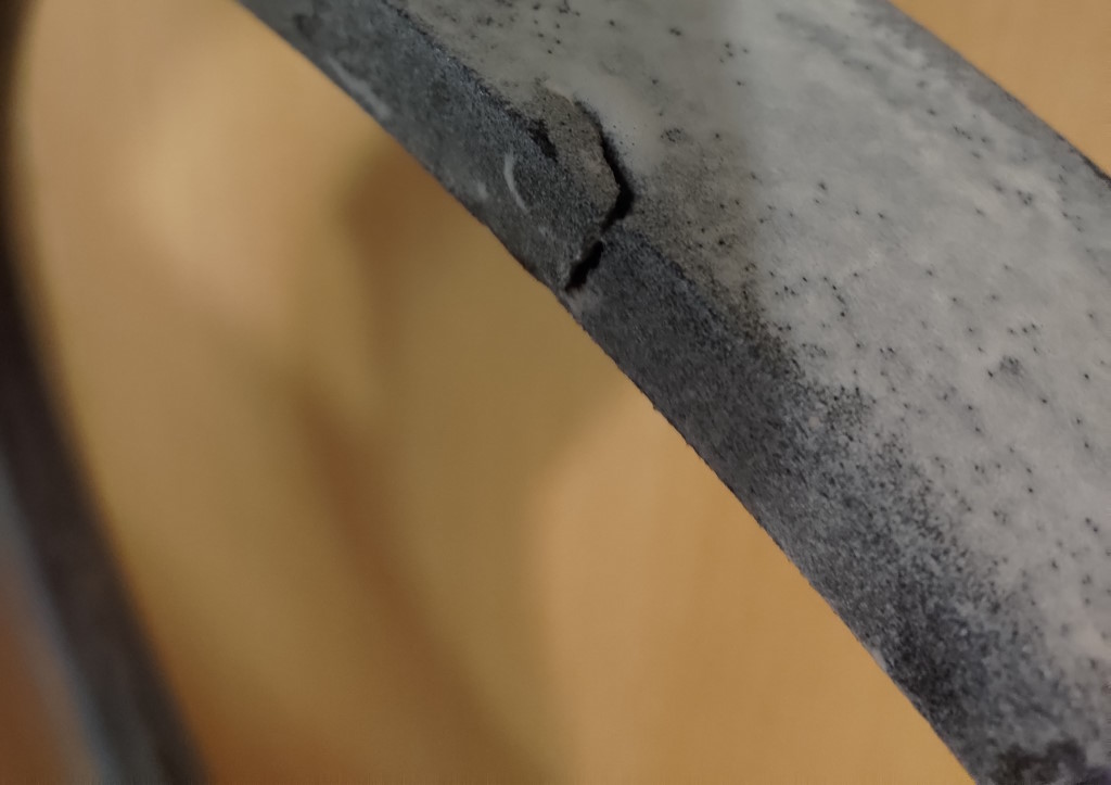

According to Rimpact, these "Original V2" are wider, tighter on the rim, and more resistant to stretch. Given my experience of fitting them and refitting V1s when swapping tyres, this sounds like everything I don't want! Anyone fitted them and found any difference in difficulty?
Following all the tips and having done it a few times, it takes me 3 hours to swap a pair of tyres with Original V1s. XM481 (30mm) and 2.4" DHR2/Dissector/Baron Projekt. Min tyre width on the V2 is 2.4" (was 2.3"), min rim width 25mm (was 23mm), so I'm guessing it's a tighter job.
I'm weighing up whether to ditch inserts altogether, stock up on a few sets of V1s while they're still available, trying my luck with the V2s when the time comes, or trying the new XC ones (1.5-2.35" tyre & 20-30mm rim). I'm on EXO casings, 70kg and not a hard charger, so they're really just in case and letting me drop pressures to 20f/22r psi instead of 23f/25r. Only got this one cut on the rear all year, not sure what the outcome would have been without any insert.
cut rimpact
