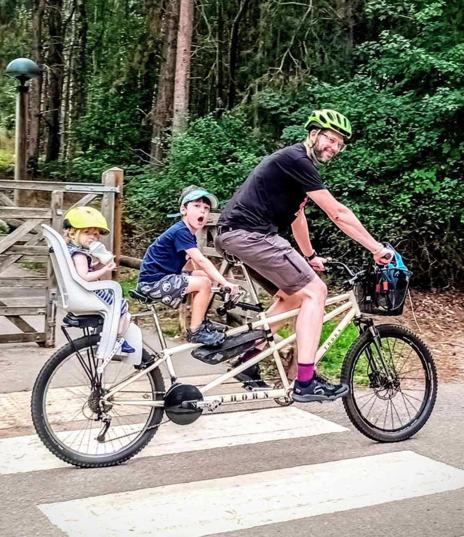

Posts: 3596
Tandem, tandem, tandem!
It will be "fun" with a partner on route home from the pub
Mine seen here with wife sized seatpost.
Photo taken by wife for reasons I can't remember😀 probably not wanting to ride it and unleash the 5 year old on his bike. 🤪
In a more useful suggestion I had  about 5kg in the basket and the handling was very weird. I'd get pannier bags for a proper shop.
If your marriage won't tolerate a tandem, will it tolerate a pinion passenger? Will the back seat driving not be similar?

We love our Tern GSD but it’s over your budget. I’ve picked @ahsat up from the train station a few times, but it’s main job is getting shopping back over the chevin without getting sweaty. It’s brilliant, it makes mundane stuff fun.
As for two adults up a steep incline, it’d be possible, but might be hard work. You can rent them and try it out first.
From our test ride:
Posted : 13/08/2025 7:34 pm
