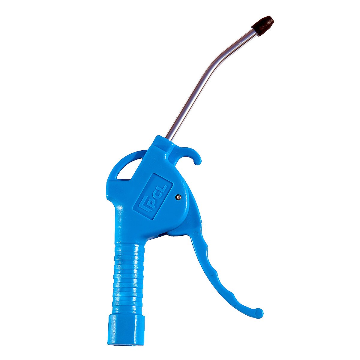

Old car gun and a Topeak Super Chuck, was about £7. Cut the old head off and attach that, does tubeless with the core out.
With that setup and a good seal that small Stanley compressor works a treat, but you need a bigger tank for tricky tyres.

Put the end of this from screwfix....
Into the end of the rubber hose of one of these from a cheap track pump/replacement head or broken old one...
The rubber tube seems a good size. Mine works without a jubilee clip but add one if you like.
Works quite nicely off my 6ltr compressor.
