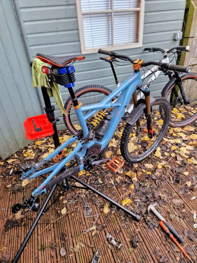

Posts: 14342
Ended up with the Merlin one for £40
Seems to do the job it was designed to do

That Merlin one looks suspiciously like the Lidl one I own. Mine has feet you can secure but other than that it's identical.
