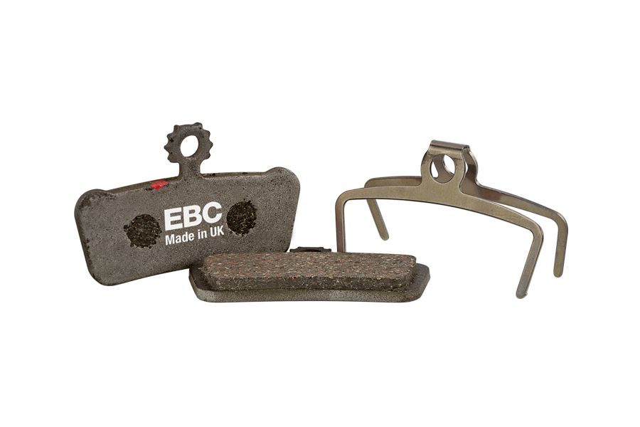

https://ebcbrakes.com/product/ebc-red-brakes/
