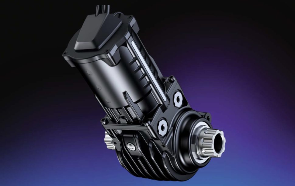

Porsche - the company behind Fazua lightweight drive systems - cites a fundamentally changed market.

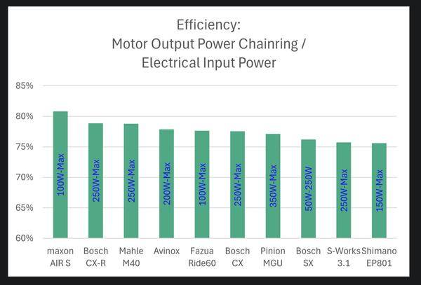

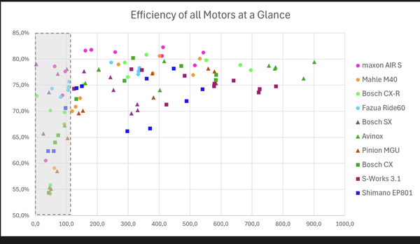

"The Avinox 700 battery has an energy density of 220 (wh/kg) and 3.18kg.  Their old 800 was 214 (3.74kg).  Bosch's 800 battery weighs just 160g more.  The 630 battery in my Orbea Rise is 219 (2.88kg). Removable batteries result in a heavier frame, heavier mounting stuff/connectors and a heavier battery.  "
I was comparing it to the old Levo 500wh (about 160wh/kg) battery when someone said they'd not improved in 8 years.
irrc avinox is more efficient than others when running at 700w (boost on bosch) due to better heat management needed to cope with higher power.
Range tests are similar for both (below), but thats running them both on boost (750w bosch, 1000w avinox). Match them for speed/power and it'll get more range.
https://enduro-mtb.com/en/e-bike-motor-test-range-efficiency-vertical-rangee-bike-motor-test-range-efficiency-vertical-range/

That's really not a comparable battery - it's a removable battery with the mounting hardware and a 'rock guard' attached.  The removable 600 Avinox battery drops to an energy density of 200 and that doesn't include the cover flap.  I suspect larger batteries are always higher density as the case and mounting hardware are don't change much as the battery gets bigger.  The 2019 Levo 700wh battery had an energy density of 184 for example.
Posted by: HoratioHufnagel
Sorry - you were claiming double the range for the same weight.  I dont see anywhere that suggests that.
In fact, the efficiency of all the motors was remarkably similar.  (and they note they aren't sure about the Bosch SX and Shimano motors as they got more variable readings and seemed to have trouble with them in their test rig)
This graph shows their results.  Now they thing the low Shimano and SX dots are unreliable.
So all of the motor are actually between 75 and 80% across the working range (and the variability where some are dipping up and down on different readings might be recording/methodology error).  I can't see anything between Bosch CXR and Avinox there.
Most of their testing is really good but I'd question that the best way to test the range is to do it in full boost mode on all the bikes. I'd have gone for trying to normalise the settings so that they were all the same power.
So in summary
- battery energy density has only increased marginally.  larger batteries have a higher density. non removable batteries are best.
- theres not much at all between any of the motors in efficiency.  But if we call it 5% and says that translates directly into extra vertical that might be an extra 75m on my stretch target 1500m out of my Rise.
