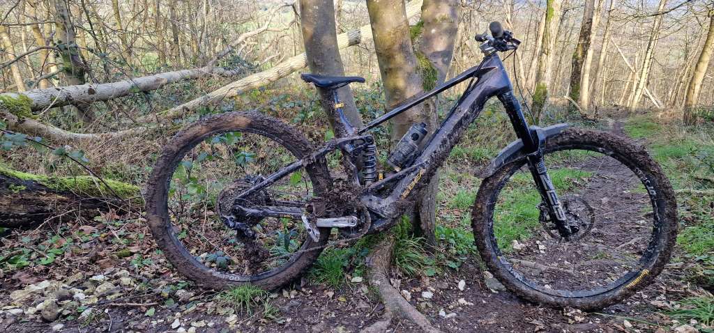

Posts: 3998
Yeah, the Orbeas seem like Californian brands, built for Spanish winters, not UK! No additional seals on the pivot hardware. Funnliy enough the inner of the small ones at the rear of the linkage are both seized on mine but outers aren't.
I'm pretty much 100% they are genuine Enduro Max but if the water gets in doesn't seem to make any odds. I'be ordered a linkage bearing kit as the others are OK, have popped seals and regreased, I am thinking I will top up the new ones though, I know it might compromise the seals but it doesn't seem to make any odds and I can install them with that side facing inwards.
I am going to try just scraping the mud off as well but as about 50% of winter rides have the bike looking like this it's a challenge....
