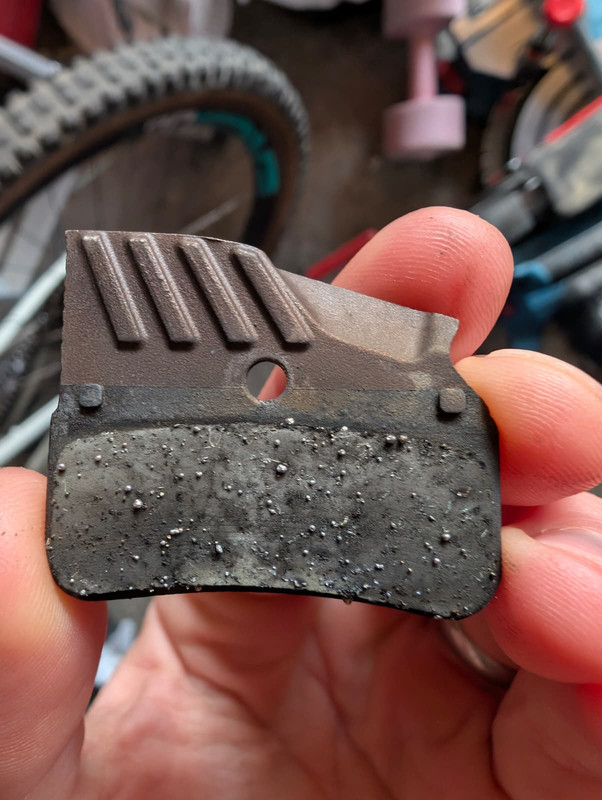

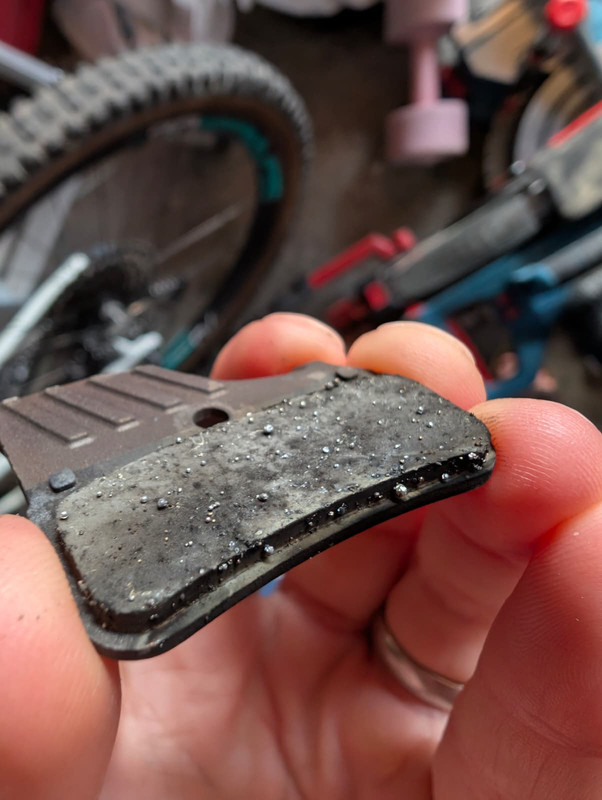

Has anyone had this before? Any idea what is causing the contamination?
Bike hasn't been used in a few months, brake was really noisy, and I get these metallic blobs oozing out of the pads when I get a blowtorch on them and heat them up.
It's happened to several pairs of pads this year (Various brands, so its nothing to do with any specific brand), but I'm not sure whats causing the contamination
https://ibb.co/kVx6tYzH
https://ibb.co/3mrKynW7

Bit what specifically are the pads? Sintered? If so, they contain metal in the pad material so maybe you are just melting out the metal from the pad itself.
Sintered pads are generally squeally in wet weather, which correlates with your comment about the brakes being noisy.

It looks like blobs of solder all over the pads. And yes, they are sintered pads, I did wonder if I potentially over-heated them with the MAP gas blowtorch, but I didn't think I got them that hot. Regardless, their braking performance had gone so they were definitely contaminated.
RE the noise... nope, this was full 'my brakes are ****ed' howling like a banshee noise with a massive lack of power, also just riding them out the garage on a dry day, and the front was fine.
Reposting images from another host incase nobody can see them...
Posted : 19/11/2025 12:22 pm

I've had a similar looking thing with pads that I've heated on the gas hob.
As far as I'm aware I just got them too hot and it melted the metal particles in the friction material.
For what it's worth I used the pads until they were worn out and they stayed in one piece.
A quick Google suggests that in ambient air, a blowtorch can reach temps of 2000deg. C.
The particles in sintered pads are very small, so will absorb that heat & melt pretty fast.
It sounds like you might have an issue with contaminated pads, but I think the balls of metal are a red herring & you are just overheating the pads with a blowtorch to get this effect.
Maybe you just have the leaky calipers issue which can affect Shimano brakes?
You mention using clutch fluid - presumably for the hydraulic fluid in the brakes?
Is this compatible with the seals in Shimano brakes? I am not familiar with it.

Yeah I think you're right, and I'll be more careful with the blowtorch in future 🤣 Although I'm sure I've heated other pads more than I did for these ones in the past with no blobs, but maybe not. The pads are straight in the bin regardless, not worth the risk.
Yeah LHM is a compatible mineral oil that you can use with Shimano, cheaper and easier to get than the normal stuff, I've used it for 10+ years and never had an issue with the seals (other than this possible leak)
