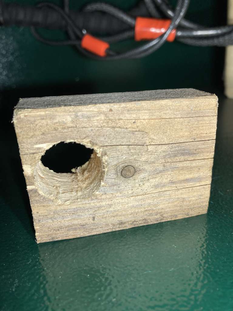

IMG_2322I’ve changed the frame bearings on my Orange Gyro with items I had laying in the shed
Just drilled a hole in a piece of wood to support, it worked fine and was free, used a drift and two blocks of wood and knipex pliers wrench to press the new bearings in
I followed theOrange Bearing Guide from their website
If you have some space to work and the tools and time it is certainly doable
If you remain in doubt or intend to keep your bike for a while, may be worth checking out Bearing Pro Tools as they seem good value and built specifically for the job
