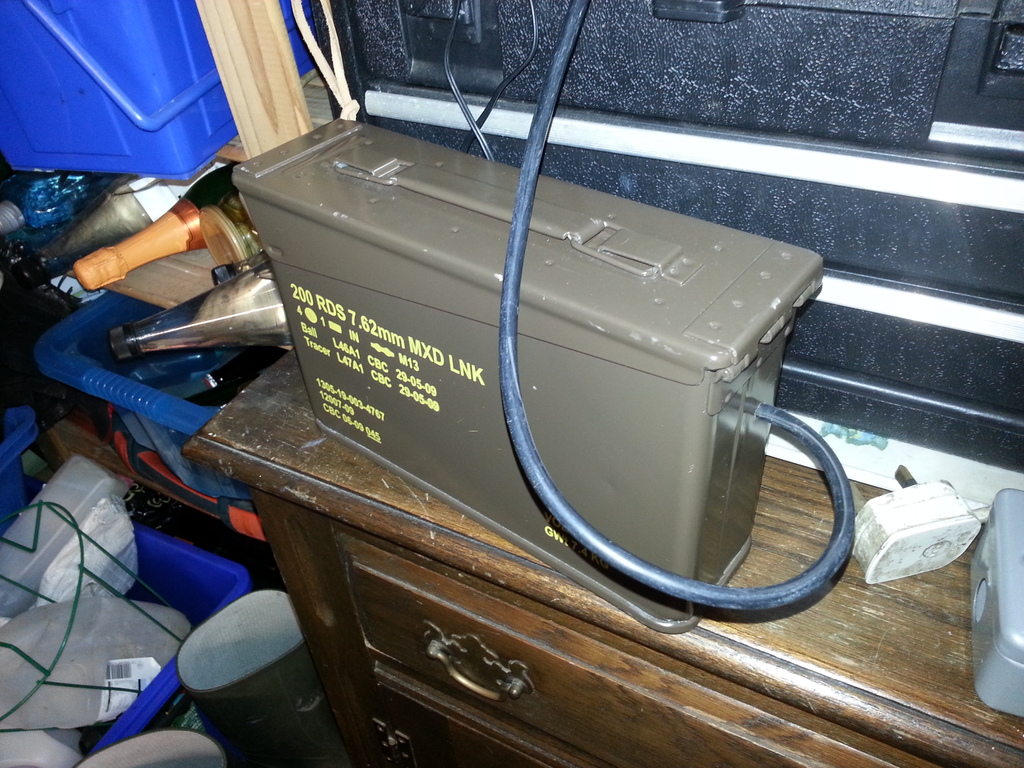

My battery charging box.
Have put a couple of vent holes in it.
