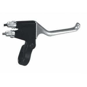

I know I'm not (and I suspect the rest of the STW masses) the target market, but still not sure that this will catch on
[url= http://www.bikebiz.com/news/read/single-lever-brake-system-gets-asian-production-slot ]single lever brake system[/url]
Seems a solution looking for a problem

if it worked with disks 😉 i could have used this on 2 occasions ..... ever tried converting a bike for a below the elbow amputee ?

this line says it all for me
The system eliminates the risk of over-applying the front brake and causing over-the-bars accidents
I think this is more likely with Disc than V brakes!
But that surely is about the only possible sane application?
Posted : 08/06/2011 8:46 pm
I've seen one done, complete with a tiny, adjustable bias valve

Thought this had been done years ago, for back wheels of trikes in particular,

But surely you want to vary the amount of braking force to front and rear wheels at different times? I thought that was why we had 2 individual brake levers.
Although I can see it could have some bespoke applications 🙂

nice. i can see how it works, and approve.
personally, i would run two brakes off one lever, and run a rear bias.

You can do this with HS-33s.. I've seen it on an adapted bike.. Just daisy chain them together by replacing the bleed valve with another hose! There's no simple way of biasing them though, but the ones closer to the lever move first, and you have to set them up very close to the rims.

Honda Blackbird used to have a braking system that applied both ends, but I think it was 70/30 biased. Would be quite easy to rig up with a hydraulic circuit.

Hmm, applies the back brake before the front, modulates the front so you never get maximum braking power when you need it. I'm out.

..i configured a one lever two brakes arrangement years ago using a Triumph Bonneville 1 into 2 throttle link, the bias was easily set with inline cable adjusters.(running V brakes)
on the road where conditions/grip, were fairly constant, they were, unbelievably good!!!
but take them off road, XC/downhill sections ..../loose scree/wet mud, absolute disasterous!!! and since i only could afford the 1 bike i had to ditch the system.

Does seem like a good idea for limited applications but I really hope it doesn't catch on with mainstream bikes.
Think after one ride with that anyone doing 'proper' riding would realise just how much modulation there is with the brakes. There's times when any front brake is a seriously bad idea (steep hill when the back end tries to lift anyway). Front brake can also be used at a lot more than 30% bias in a quick stopping situation.
