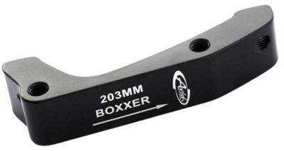

Tried this:
[img] http://media.chainreactioncycles.com//is/image/ChainReactionCycles/prod15261_IMGSET [/img]
And the caliper is far too high in relation to the rotor, so the pads would barely touch the rotor when the brake was compressed:

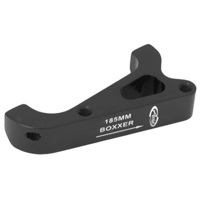

So he's bought and tried the smaller size adaptor:
[img] http://media.chainreactioncycles.com//is/image/ChainReactionCycles/prod26724_IMGSET [/img]
But that doesn't fit either.

That mount you show in the first picture looks a lot more like a regular IS to 180 Postmount adapter (I've just been out to look at my collection) Boxxer to 203 Postmount are much more squat at the upper end.

Just realised that from the op that this:
isn't the same mount as shown here:
Looks like the wrong mount has been sent.
It should sit like this:
