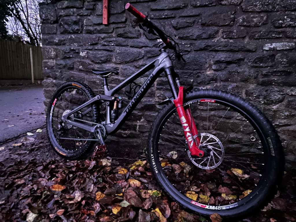

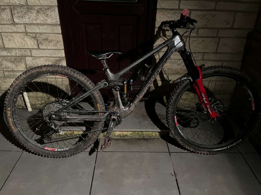

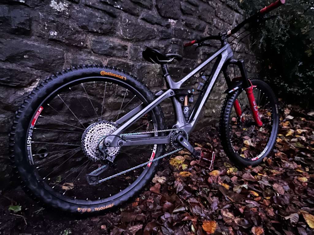

I’ve been riding a Transition Sentinel 2022 alloy frame for a couple of years now - loved it - other than it’s a bit heavy. First 29er but it didn’t feel much different to turn into corners than my previous 27.5” wheel bike (Bird Aether 7) - but it carries a bit more speed and momentum through rough stuff.
I picked up a Carbon Sentinel v2 frame from Mark on the forum and have just built it up (just a few minor tweeks to finish it) - the geometry and suspension is identical to the alloy, but it’s 1.2kg /2.6lbs lighter. I’m going to miss the bright blue of my last frame but the new one is pretty nice - albeit subtle.
Build is stuff straight from my old sentinel - Lyrik ultimates / Code brakes / Xt mech and shifter / SLX cassette / xx1 oilslick chain / 210mm Oneup dropper / X1 carbon cranks / Hope Pro4s on XM481s / brand x carbon bar / Thomson 50mm stem. Guessing it’s going to be about 32lbs ish but will weigh it next few days.
IMG_3525

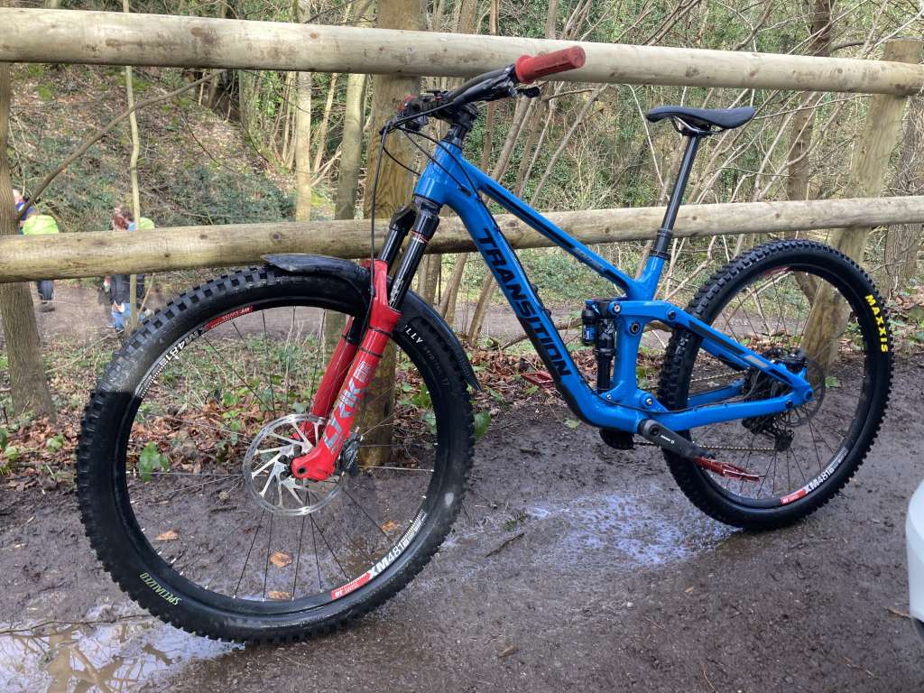

Sneaky mention that I have a medium Cascade Blue Transition Sentinel Alloy 2022 frame for sale in the classifieds / Pinkbike / eBay. Has a float x, axle, seat clamp with it. Mostly new bearings throughout where needed / boost 148 rear axle / metric trunnion shock / bsa 73mm screw in bb shell / tapered zs 44-56 headtube.
IMG_9258

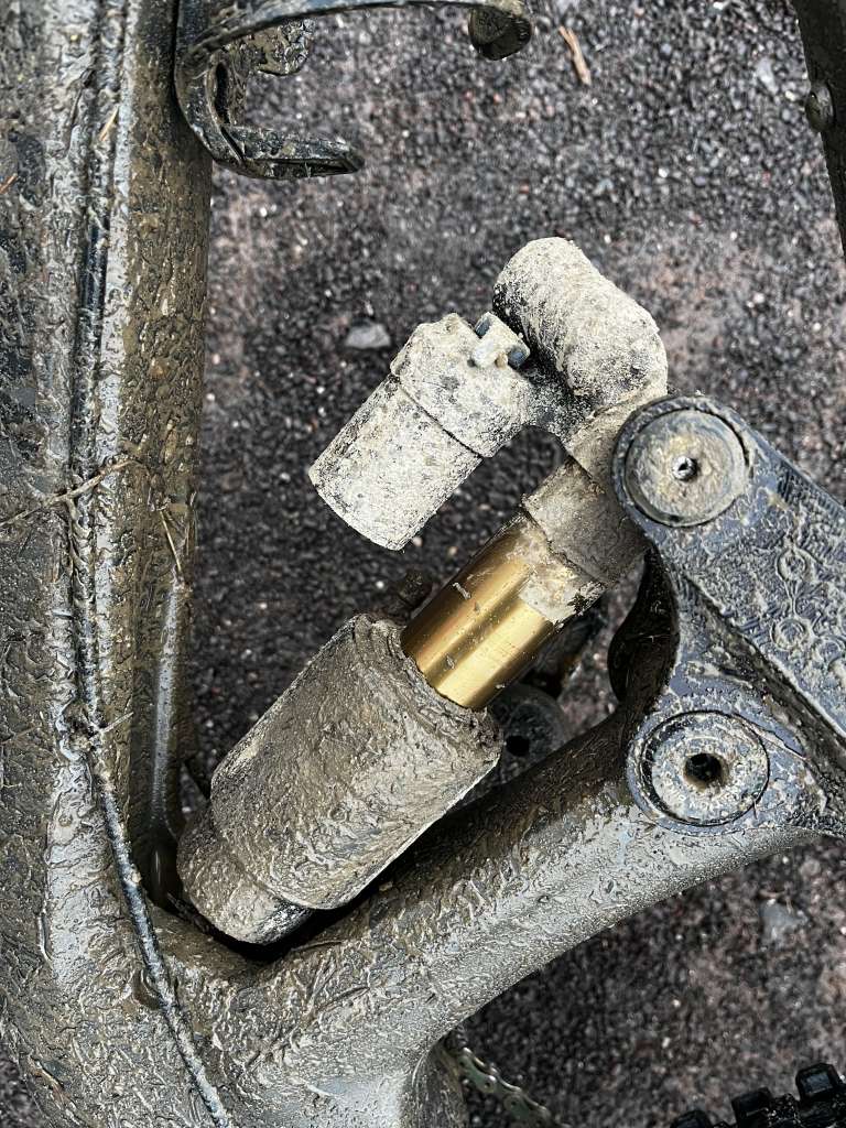

Little night ride tonight for the first time in ages. Surprising how different this frame is vs my alloy one. Identical geometry / shock linkages and leverage etc. Feels more lively in east flow trails - but is perhaps knocked off line easier on rocky stuff.
Going to fit my coil shock on as soon as I get a chance. Going to send the X2 off for service / upgrade to 2024 internals - I don’t think it’s super happy at the moment. Sounds very squelchy and seems to be using a lot of travel considering it’s set to about 26-27% sag ish.

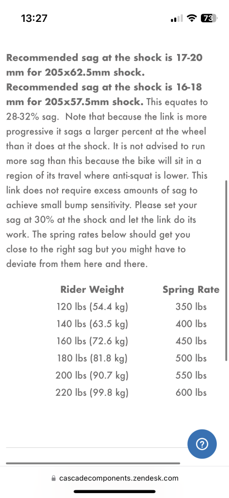

Posts: 2110
What’s the recommended sag? My smuggler had a suggested range of 30-33% I think. It was certainly better using recommended range.
Posted : 23/12/2023 12:37 pm
Posts: 10265

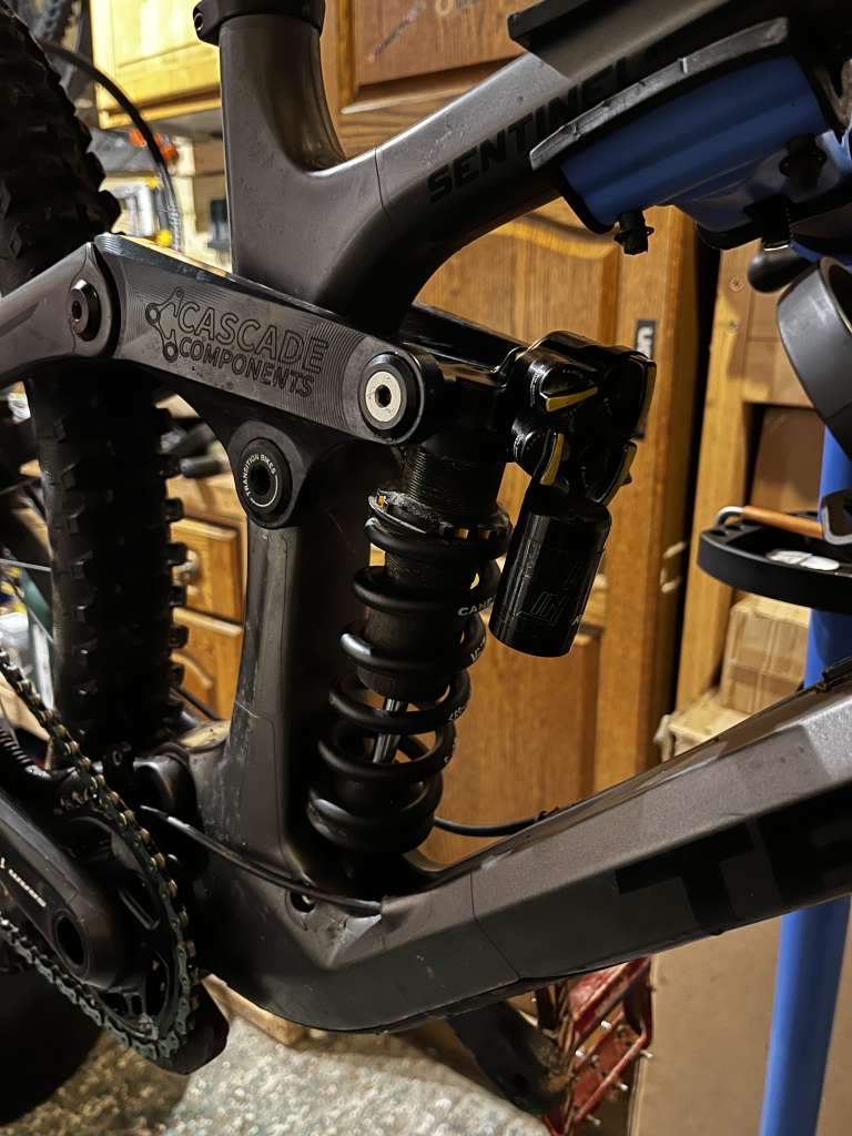

With the cascade link the below applies. Actually my sag was based on % of travel in the shock. So actually I’m about 28-30% as setup. So I do think the X2 needs some work - sussed it with Silverfish - it’s out of warranty so if I pay for the service (£139) they’ll rebuild it with the 2024 internal seals that should hopefully fix the issues fox have had with the shock. I think I’ll get the stroke reduced to 57.5mm too - so the rear will be running 155mm. With the 165mm travel I was clipping my pedals occasionally which I wasn’t doing with 155mm travel.
My coil shock has a 500lb spring which worked well on the alloy bike so should be decent on the carbon bike too. 450lbs was too light when I tried it before.

Kitsuma is now on but not ridden it yet. Probably be the weekend after this one before I get to ride it as I broke my Maxx D a few days ago so night rides next week are probably off the agenda (unless I can find some old Chinese lights lying round in the garage).

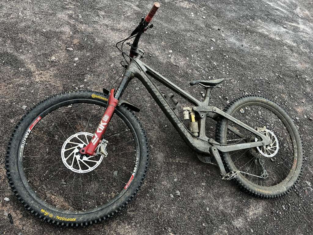

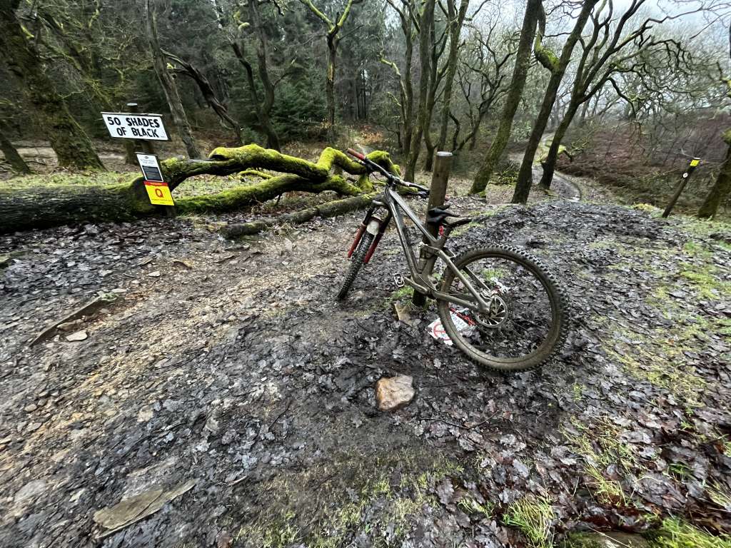

Did my first uplift day on the carbon frame at BPW on the weekend. It defo feels a bit different to the alloy version of the bike despite exactly the same geometry / specs / kit on it.
I had the X2 serviced and rebuilt with the 2024 bits on it which (hopefully) fix the known X2 issues. So far it seems to ride quite nicely - vs the coil it loses some outright grip but gains some pop and liveliness. The coil needs to go off for a service as it’s making a clunking noise at the moment so the x2 is getting some use.
