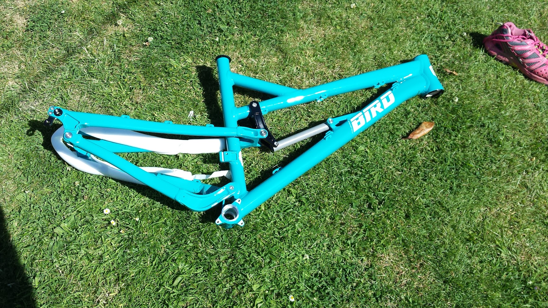

For anyone interested... new Bird Aeris
[img] https://lh3.googleusercontent.com/tLppkQherxSXTplXtp_hD-z8cFrs0c8DpVWS9KjW4MY=w1769-h996-no [/img]
[img] https://lh3.googleusercontent.com/EBfHoil-7qWR1k40wOgpi0Ct5I3VDRu2wUbSGhWic1o=w1769-h996-no [/img]
[img] https://lh3.googleusercontent.com/-JAbGAveFDdT7_cpu5gveM3YejODAT-t-uPlI3GrJgg=w1769-h996-no [/img]
[img] https://lh3.googleusercontent.com/ygJHNjG7209FubzJzjq2edAVM0r2Cn-gbID8LfzxKU0=w1769-h996-no [/img]
[img] https://lh3.googleusercontent.com/OHnsw8KRPkaxq0Xi_ISdNPerLbk0EPZNfX9g10zjUnI=w1769-h996-no [/img]
[img] https://lh3.googleusercontent.com/bSZxGu-ketkZwg5utf8KGzIx2IJCT7tuUxinvRfGQBk=w1769-h996-no [/img]
[img] https://lh3.googleusercontent.com/0PZ_-Zj6_pRa2F0-nDPL1yVJzpFbYQ2YJ9vDuRRQow4=w1769-h996-no [/img]

Assuming you don't have a sub-750mm bar, are you confident that the fork and shock after set up right?

Bike looks great though.

BTW- it looks gorgeous.

lovely foxgloves, and i like that you've coordinated your trainers with them. Do you change your footwear depending on which flowers are blooming in your garden? - because that's a dapper way to roll.

Geometry aside that's a lovely colour
Posted : 02/07/2015 12:19 pm
Posts: 1325
It does indeed look good! Ive just had one delivered too, same colour ๐Ÿ™‚
Posted : 02/07/2015 12:27 pm

Colour is great, I think it's a cracking looking bike. I really like the chunky welds and full outer cables and the low standover is appreciated.
Crappy looking front mech tab is erm.. crappy.
