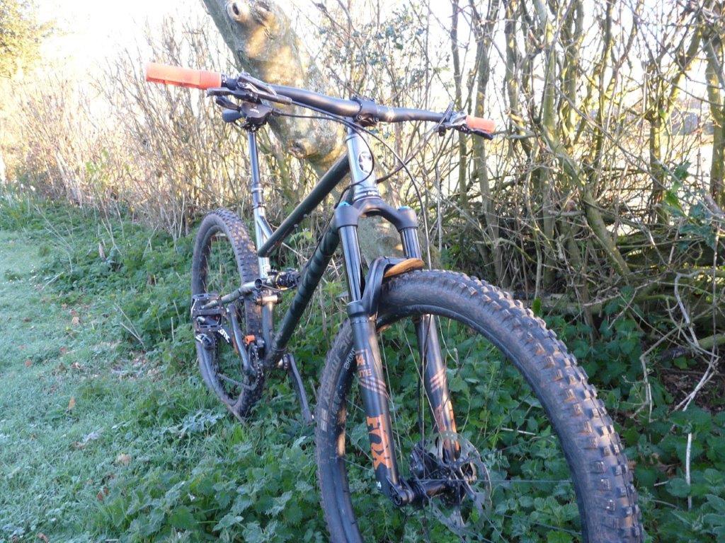

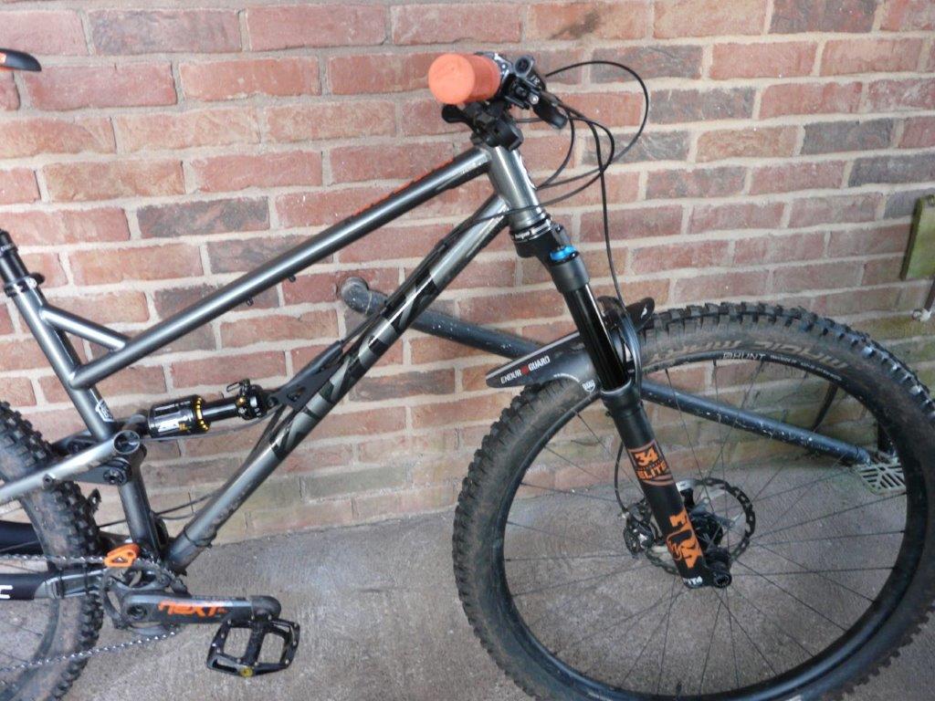

Just wanted to say big thanks to Roverpig for this thread, its been so helpful (along with everyone at Cotic) and has answered many of my questions. Roverpig's descriptions completely ring true for me, what a stonking bike! Here's my Flaremax:
[/img][/url
[/img][/url
[/img][/url
[/img][/url
Posted : 23/04/2019 8:08 am
