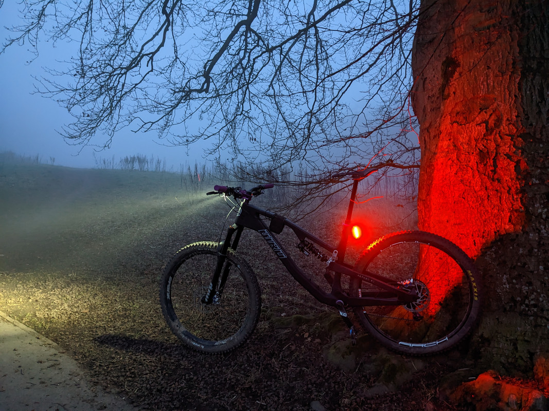

So I've finally got my new bike pretty much together (it's in one piece but a few odds still to sort, and that's where the bad idea comes in), quick spin to the office this morning but yet to use it in anger.
Hopefully it's a "one bike too rule them all" for me, tried one at Hamsterley back end of last year and it seems that a bike which fits is actually a bit of a revelation, like witchcraft as someone previously put it, and it is pretty bloody huge but feels instantly right.
The kitsuma shock will need some fettling this weekend on something repeatable, way too many dials and nothing but guess work to start from in terms of settings for those. The coil needs sizing down though I think.
Mrp ribbon air forks will need some getting used to, I nearly squished my self this morning when I tried to sprint through some temporary lights and discovered the compression does not give anything even pretending to be full lockout at max. Think the pressure needs upping in those but we'll see.
The wheels and tyres need changing over - they're a bit porky but the rear is the spare for my big bike and what I had to hand at the weekend add to that the accompanying front, the minion won't stay up so it got the wheel off my big bike plonked on at 8am today for the ride in. The dhr rear is really not my favourite tyre for pedalling on.
Fortunately I won a set of hunt trail wide from the advent countdown so they will be going on with a set of Goodyear Newton tyres over the weekend assuming my centrelock rotors arrive and I'll get my carbon rims rebuilt onto a boost hub for lighter/summer rubber.

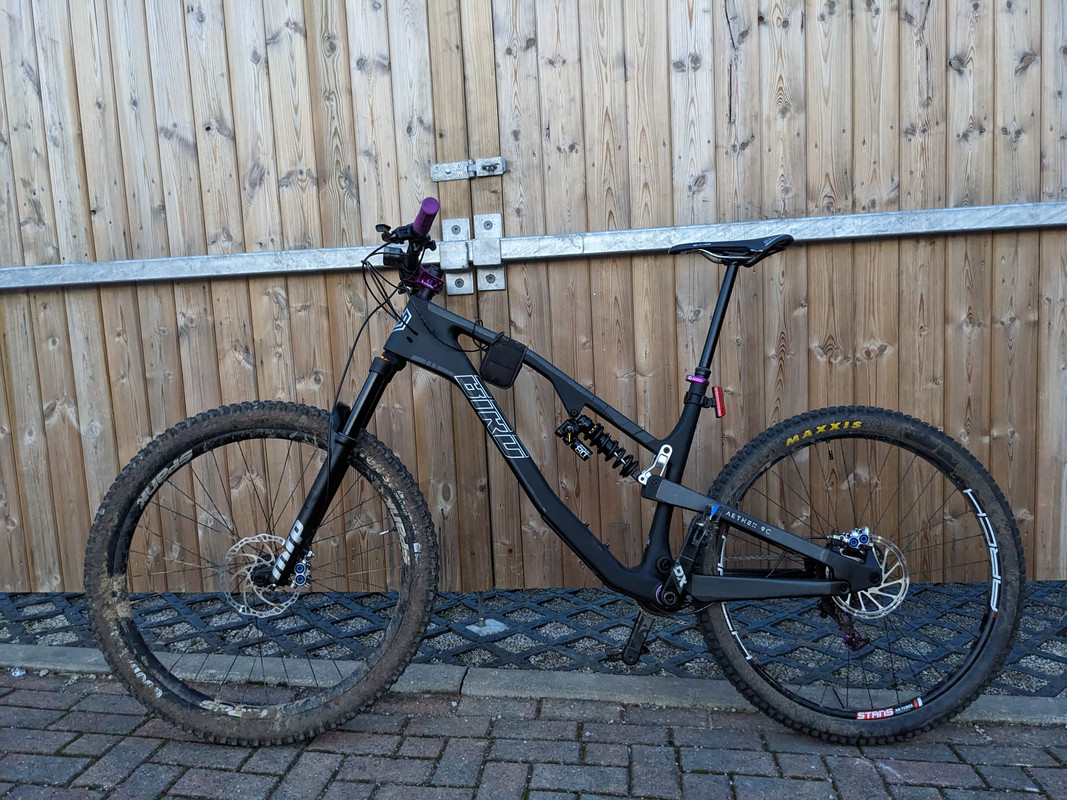

So as it stands...
Aether 9c in black, XL.
Goodyear Newton 2.6, nukeproof ard insert mounted on on a spank Spike and superstar V6.
Rear is a minion dhr 2.3 exo, nukeproof ard, stans arch mk3, novatech d462 hub.
Xg 1175 cassette.
Magura trail sl brakes, rear swapped to a 4 pot caliper though just because.
180/180 rotors
Mrp ribbon air 140mm
Raceface six c 800*30 35mm bars
Spank split 45mm stem
Granite Stash rt tool
Dmr death grip slim - I normally ride chunkier grips so I don't think they'll last but we'll see.
X01 11 speed Shifter, mech and cranks
Pnw loam lever
Nukeproof gxp bottom bracket
Kitsuma coil with a 500lb spring, (I've a deluxe inline to try if I find that overkill)
One up 240mm dropper
Selle Italia slr ti saddle.
Mallet DH pedals.
Now for the bad idea...
The cassette and chain need replacing & I really fancy axs because bling, but I really don't want eagle, 50t is pointlessly large for me - I very very rarely want a longer gear than 32/10 so won't be putting a bigger ring up front to take advantage of the larger sprocket and that means it's just weight and expense for nothing. I also run 11 speed on the big bike so going 12 speed on one will, inevitably, mean going 12 speed on the other in due course. Then I got to thinking about an Eagle Shifter paired with a xplr 44t rear mech and xg-1271 10-44 cassette. I'm still not sure this is a sensible idea - it's still a lot of money for "ohhhh no cables" but, how bad or an idea is it? Has anyone got any time on the xplr mechs? Do they look too fragile for mtb use?
Anyhow, time for a few photos I guess (I did take one of the apprentice stood next to it for scale/comedy value, the saddle fits neatly under her shoulder, but I don't suppose I should post photos of random youngsters on the internet)
Not the best of evenings for getting shots of the bike on the ride home but there you go, we've all seen bikes before anyway.
